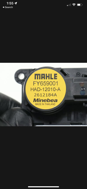

Here’s what I bought: it should be here in a few days. I’m pretty handy and I like to save money, so I’m willing to try. I understand I have to remove the interior plastic in the back to expose, do I have to take the seats out or anything extensive like that?
May 30, 2022 at 4:57 AM
  • 55,808 POSTS
It does look like the seat must be removed to gain access to the rear AC/heater unit. Please let me know how it goes.

I finished!!! Getting to the actuator was a bit more challenging than I thought, but all in all, it wasn’t too bad.
