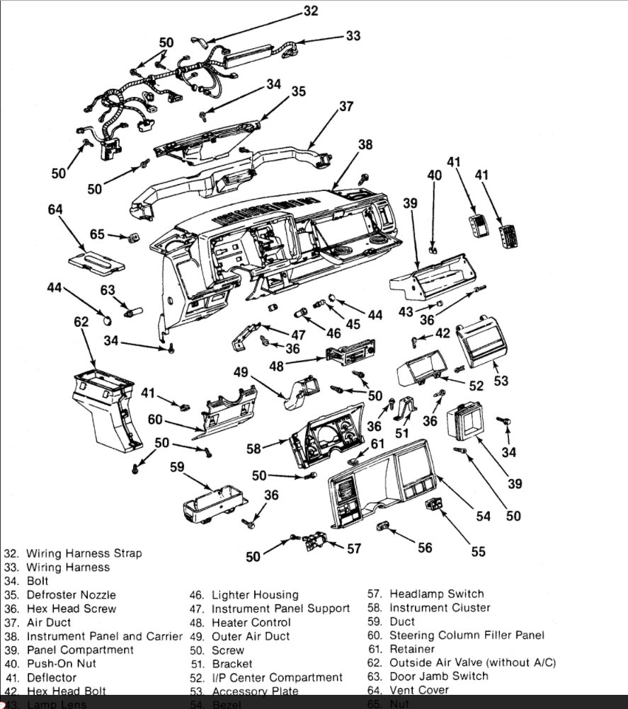

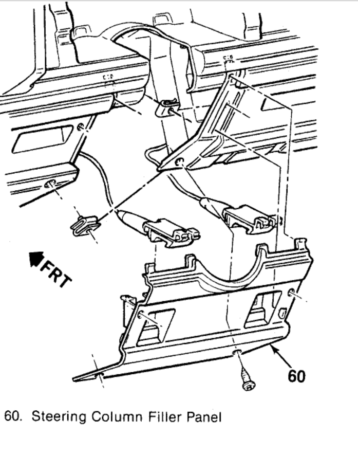

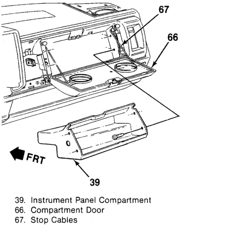

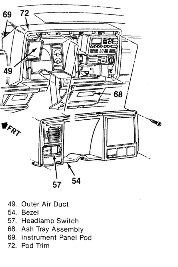

How do you remove the rear A/C fan switch?
Jul 24, 2017 at 4:14 AM
Experienced Mechanic
55,594 POSTS
You must remove the dash panels to gain access to the switch here are some diagrams (below) that will help you get the job done.
