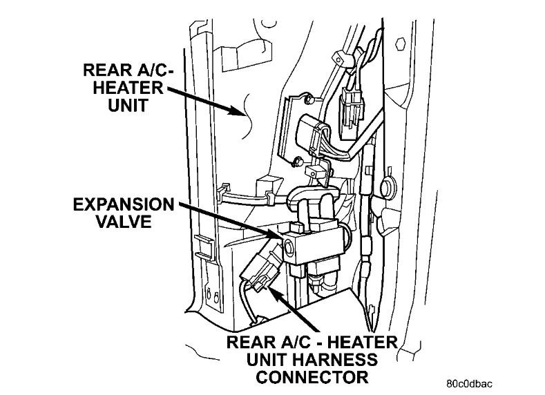

Rear AC blows ambient temperature
2006 DODGE CARAVAN
150,000 MILES • 3.4L • 6 CYL • 2WD • AUTOMATIC
CLAYTON QUICK
Bought van a few years back. Front AC works great, compressor engages as it should. Refrigerant pressure is good and does not leak. Just replaced rear blend door actuator and verified that works. But rear will not blow AC air. Only ambient or heat if switched to heat. What could be causing no AC?

Good afternoon.
What are the high and low side pressures while running?
If you feel the lines under the van while the AC is on, how does each feel?
