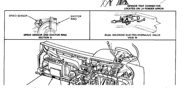

Are there any codes related to the ABS? If you remove the sensor from the differential, is the exciter ring clean? I've seen the exciter get clogged preventing the abs from actuating.

Thanks Joe for your quick reply. As I mentioned in my question, the ABS light come on and goes off when I start the truck. It is not illuminated which I interpreted as the system passed its self test. I did ground the terminal below the dash on the passenger side with the key on in the run position but was not able to generate any code flashes. Also, before I crawl under and pull the diff. sensor out, I was wondering if, since the speedometer is working wouldn't that indicate the sensor is okay? I have an E40D transmission.

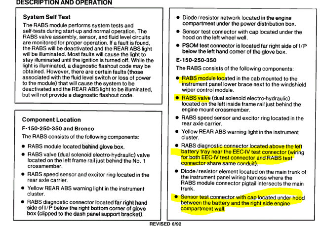

Do me a favor. I was trying to see if there were any technical service bulletins that may help. The only thing I was able to find is part relocation info. Interestingly, they mention a few different test ports. See if anything seems relevant to you. See pic 1.

I double checked Joe, even the master cylinder fluid level. The only tests ports I see/have are the ones I've described before. According to my Haynes manual, some of your highlighted locations are for earlier models (RABS I). Plus my battery is on the right so I'm assuming the one your notes indicate may be for a diesel. I also wonder why when I ground the terminal behind the glove box, I don't even generate a code 16 (System okay)? Any additional thoughts? I'm at a loss.

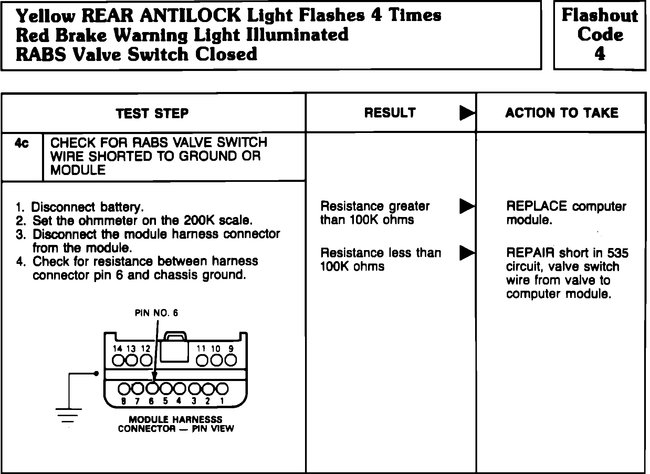

Do me a favor and complete the attached diagnostics. The module itself may be bad.

Joe, grounding pin 6, I get no reading on ohmmeter.
Mar 24, 2021 at 11:06 AM
  • 110,248 POSTS
That is a problem. Confirm the wire itself which comes from pin 6 is not broken or damaged. If it isn't damaged, it sounds like the module is bad.

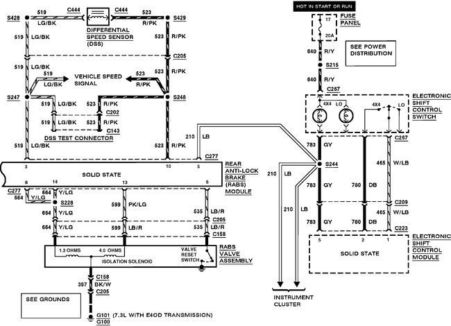

I get nothing when checking the line (open circuit?). I do get a reading when I connect Pin 6 to another pin at the connector (black/white wire). About 60 ohms and when I turn the key to the on position it drops by about one half. I tried to follow the line first under the dash, but the light blue/red wire (pin 6) seems to go into a module under the dash and it doesn't come out of it. I'm not sure this is the same wire since when I check it for continuity I get nothing and that's only 2 feet of wire from the connector.
The schematic I have shows circuit 535 going direct to the hydraulic valve but I may not have the best info. I do see a light blue/red going through the firewall in a large bunch but I can't seem to follow it in the engine compartment.

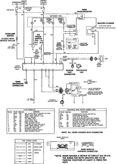

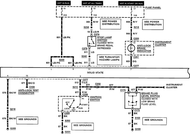

I attached all I have on the wiring schematics for the ABS. Take a look through them and let me know if they help.

Thanks Joe. They seem to have more info than mine. I'll go over the system again. One question, is it possible that the hydraulic valve is the problem? I don't see where all aspects of it are part of the system self check specifically the dump valve switch. Is there a way to manually apply power and check its operation? I guess that's two questions.
