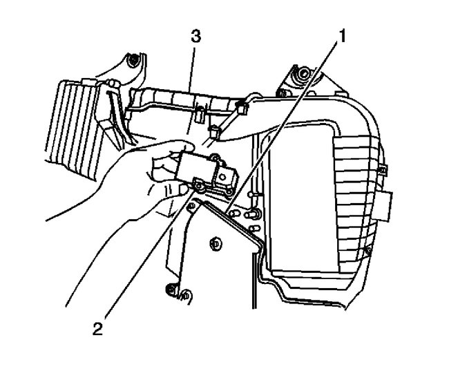

Since purchasing this vehicle only the front A/C has worked. I removed the right rear panel and noticed the hot/cold actuator was missing as the actuator door gear was broken. I installed a new actuator door and also purchased two new actuators. (Btw, they don't line up. Can you tell me how to adjust them so I can install them?) Back to my other problem, the front controls nor the rear controls will turn the rear unit on, but I can remove the fuse and reinstall and the blower will come on but only for around 60-70 seconds then shut off. Any help I'd really appreciate it....

If it works for a short time when you remove the fuse, check to make sure the connectors are clean and not corroded. Also, make sure the pins that the fuse pushes into are not loose or pushed inward.
As far as the actuator for the rear, here are the directions specific to your vehicle for replacement:

REMOVAL PROCEDURE
1. Remove the right rear quarter trim panel.
2. Disconnect the electrical connector from the air temperature actuator.
3. Remove the retaining screws from the air temperature actuator.
pic 1
4. Remove the air temperature actuator (1) from the rear HVAC module.

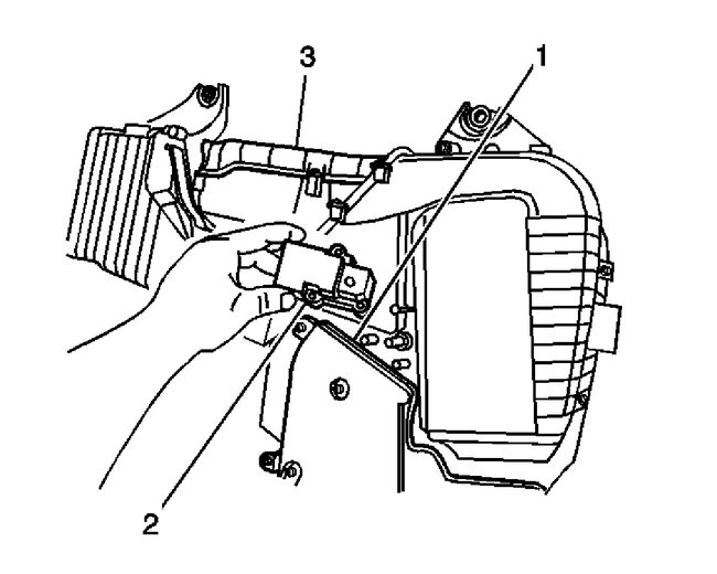

INSTALLATION PROCEDURE
pic 2
1. Install the air temperature actuator (2) to the rear HVAC module.
2. Install the screws to the actuator.
NOTE: Refer to Fastener Notice in Service Precautions.
See: Heating and Air Conditioning > Vehicle Damage Warnings > Fastener Notice
Tighten
Tighten the screws to 1.9 N.m (17 lb in).
3. Connect the electrical connector to the air temperature actuator.
4. Recalibrate the air temperature actuator, See: Vehicle > Programming and Relearning > Re-Calibrating Actuators
5. Install the right rear quarter trim panel.
