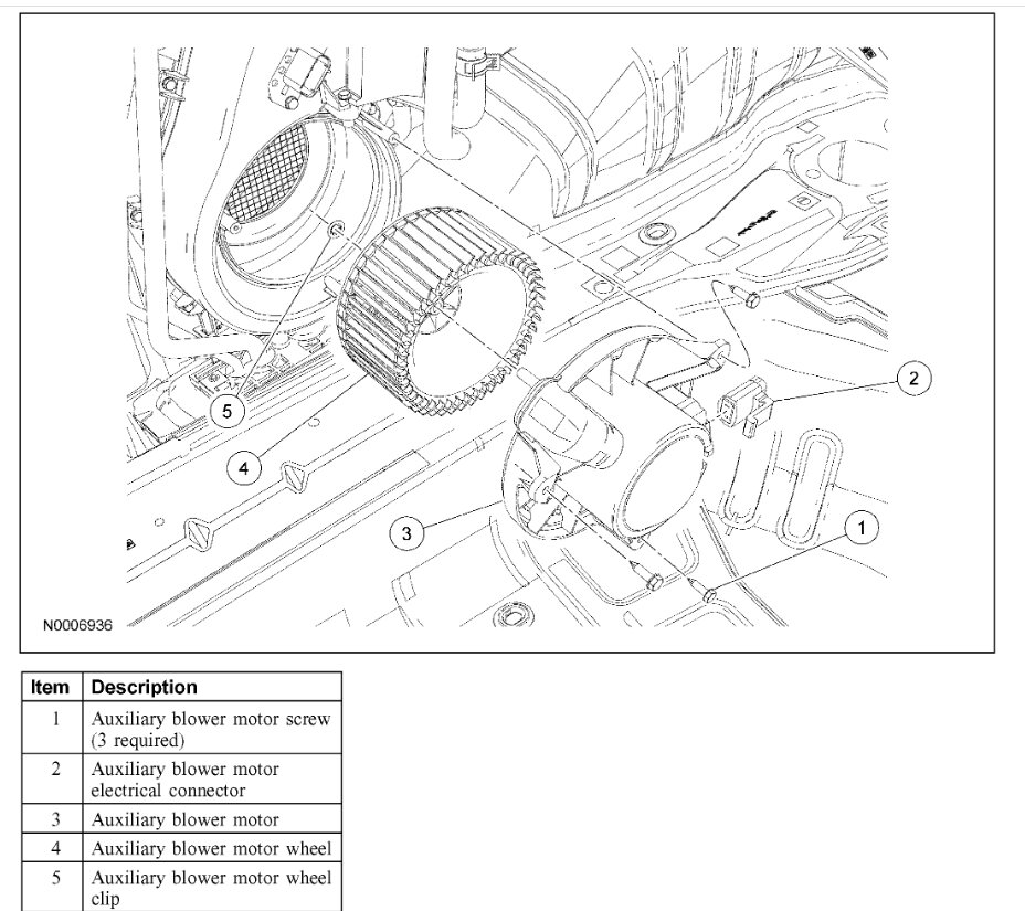

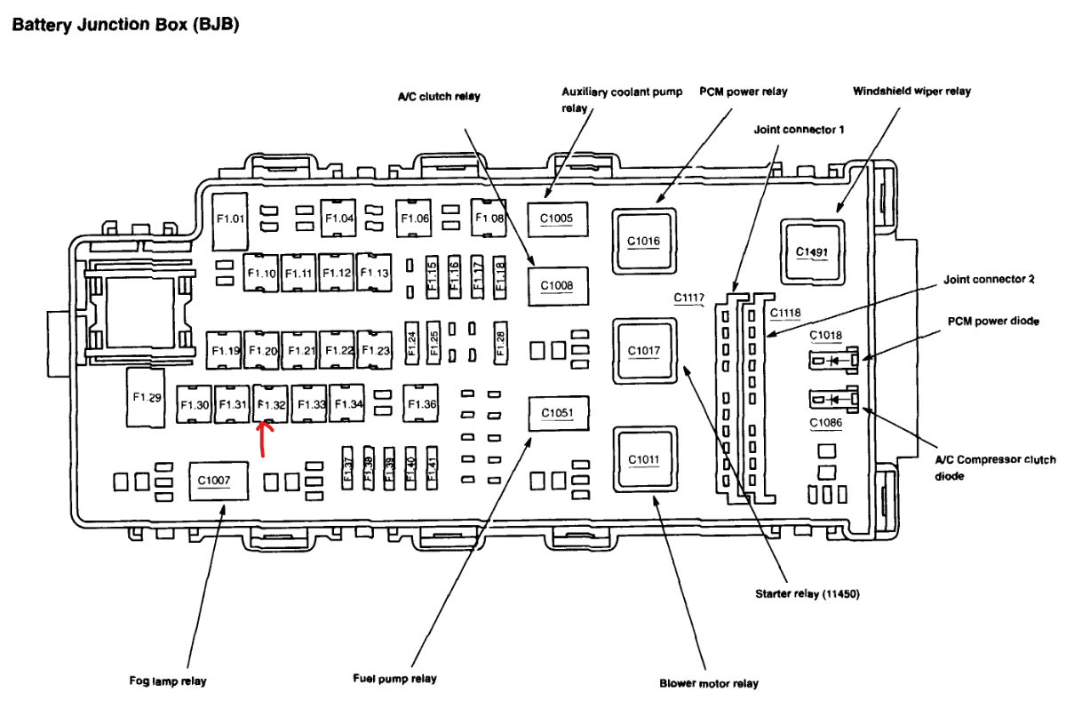

Front A/C and heat work like a charm, when I try to turn on rear fan manually, I can hear a click with no blower response. I've checked the fuses under dash and fuses and relays under hood with no luck.
Aug 4, 2024 at 11:35 AM
  • 55,423 POSTS
The first thing we need to do is check the fuse #f1-32 on the left side of the engine compartment which runs the rear blower motor. Here is a guide to help and the fuse location below:

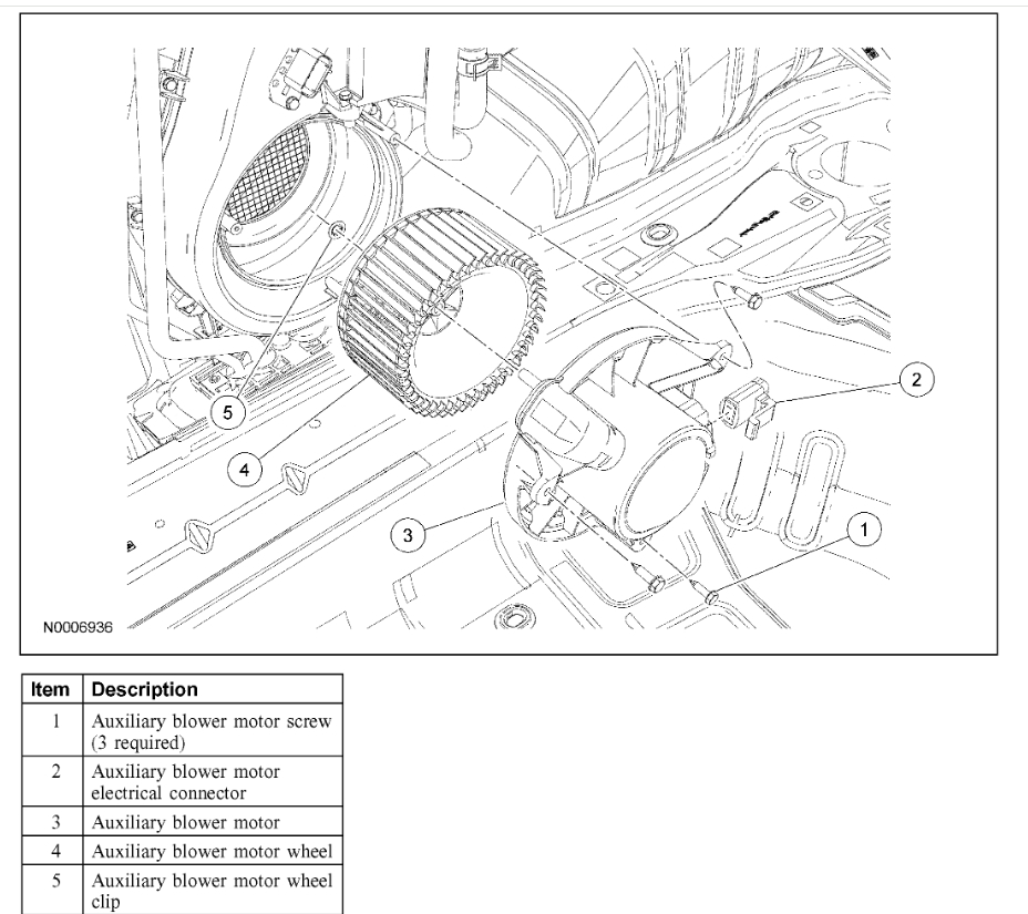

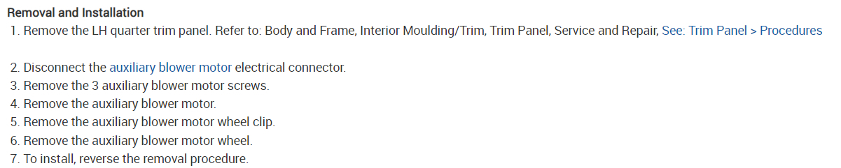

If the fuse is okay, here is a guide to help test the blower motor which has probably gone bad:
