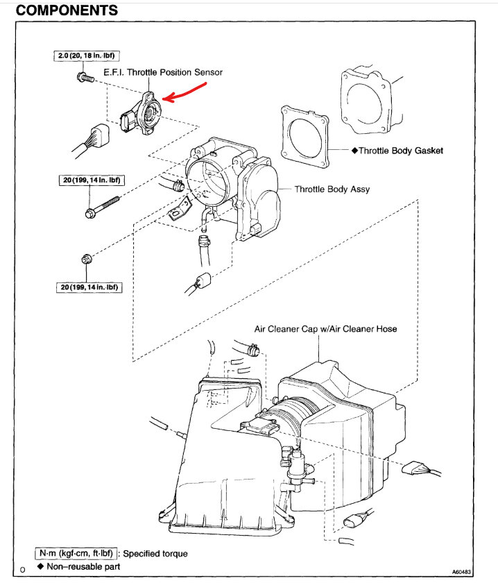

Is there a true relearn or reset for my car after doing things like cleaning throttle body electronic or when disconnecting battery? If so, please explain for a dummy? Say i cleaned my ETB a few months ago and didn't do an idle relearn and my RPMs at startup has been high. Has my idle memory been lost and can i get it back even though it has been months? Also, the last couple days right after startup I'm hearing a humming/buzzing noise with a metallic rattle coming from the TB area. Please help.

The noise is a bad sign and could mean the throttle body needs to be replaced, you do not need to do a relearn when the battery or the throttle body is replaced but there is a TPS set up procedure, here is how the job is done once the throttle body is replaced.

Check out the images (below). Let us know if you need anything else.

Mine is an electronic throttle body so it doesn't have an exterior TPS? Maybe I'm misunderstanding sorry if so.

Yes, it is, did you look at the image above? It shows the TPS sensor.

Wow, I've looked several times and still do not see the TPS on my car. And when I check online at Toyota dealerships everyone says unavailable. This could it be my problem all along? I wish now I wouldn't have even attempted to clean the Throttle body in the first place, especially when it wasn't even dirty. I'm supposing when I cleaned the throttle body, I could have messed up the TPS sensor by opening the butterfly by hand. Or maybe it just went bad, I do not know.

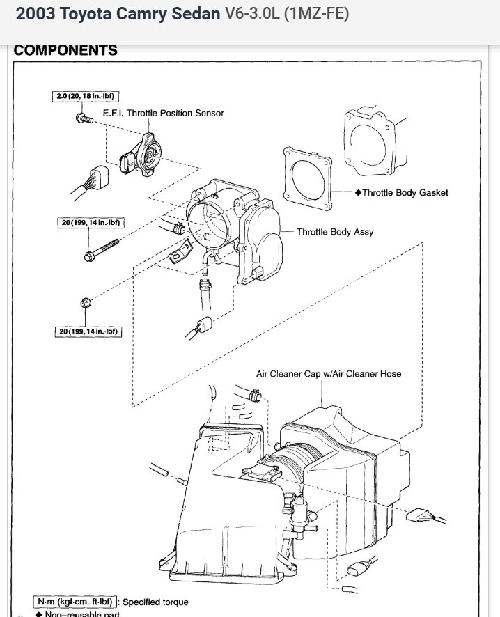

Does this make any sense? I called the closest Toyota dealership and asked about a TPS for my car, and he said that the 2004 isn't showing a TPS and since I can't find the TPS on my 03 that my car could have been produced in late 03 and possibly doesn't have an exterior TPS. I'm not good with computers and I Cannot find any information or videos on my car other than what you provided. Would you help me verify if I leave you my vin 4T1BF30K83U060515 maybe this will help determine if I'm just blind or I need to seek professional people like yourself to do work.

This is for your VIN number, can you upload an image of where the TPS is suppose to be?
