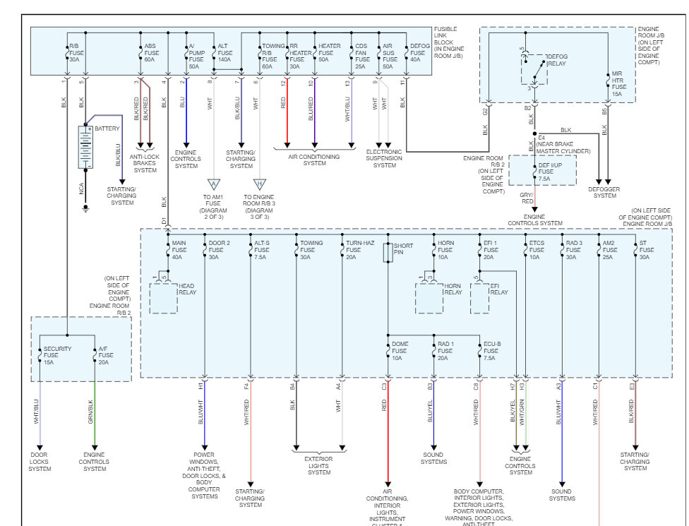

Also, I would check the fusible links this guide can help, and I have included a wiring diagram so you can see which links to check.

Hi Ken thanks for your reply, I have done most of the things suggested and shown in the videos. I am next going to change all fuse able links, plus today I traced two wires from the ignition switch that have no power at the ignition switch end. one is labelled battery the other acc. Those two IO will be doing tomorrow Friday 29th. I will let you know how I get on. Kind regards, Chris

I see an accessory relay that I would check or swap out. This relay should be inside the vehicle in the interior fuse panel.

Yes, they are all related as they all happened at once. I have come a long way since I decided to tackle this job myself after being let down by a so-called specialist. These are the next jobs I intend to tackle:
1. Change the Ignition switch
2. Change the Gear selector lever and check selector cable.
3. check red/white wire from ignition switch to 10amp ST fuse in Engine Bay (no power at either at present) that's ST2 to ST fuse.
4. check white/lilac cable from ignition to (a) 30ampfuse engine bay that's the AM2 cable.
(b)white/lilac cable from ignition to 7.5amp fuse passenger side fuse block AM1 cable.
After studying wiring diagrams and tracing all wires I think that should fix all issues.

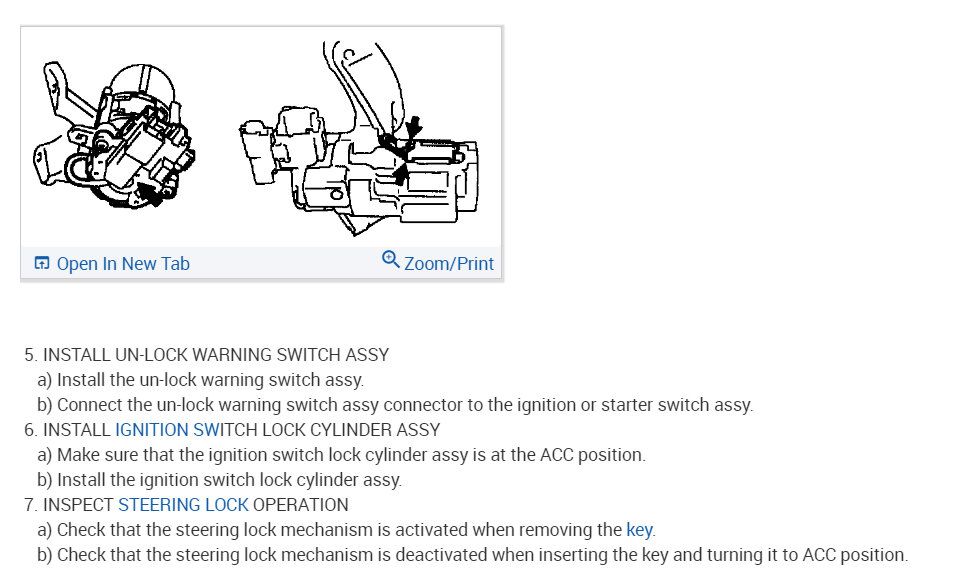

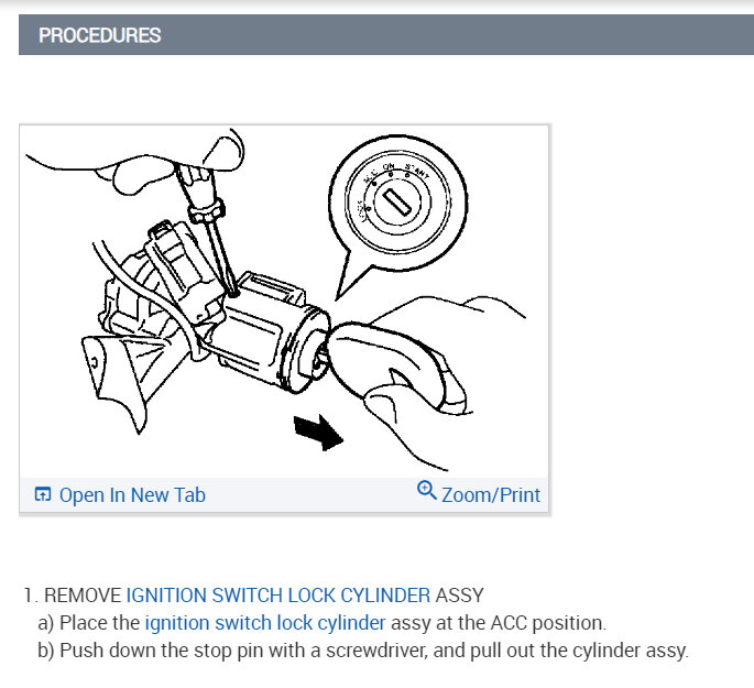

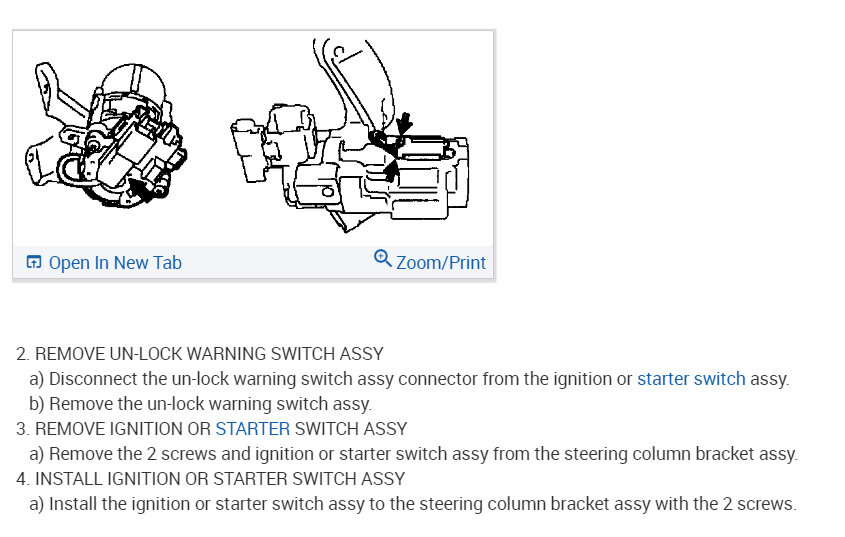

Excellent, it sounds like you have a good handle on it, if you need any instructions or help, please let me know. Here is how to change the lock/switch out.

CHRIS PINNOCK
  • 15 POSTS
Hi Ken,
Thanks for the lock/switch advice. Having a good rest this evening then tomorrow I start on the list I sent. I will give you an update on sections completed tomorrow night.
