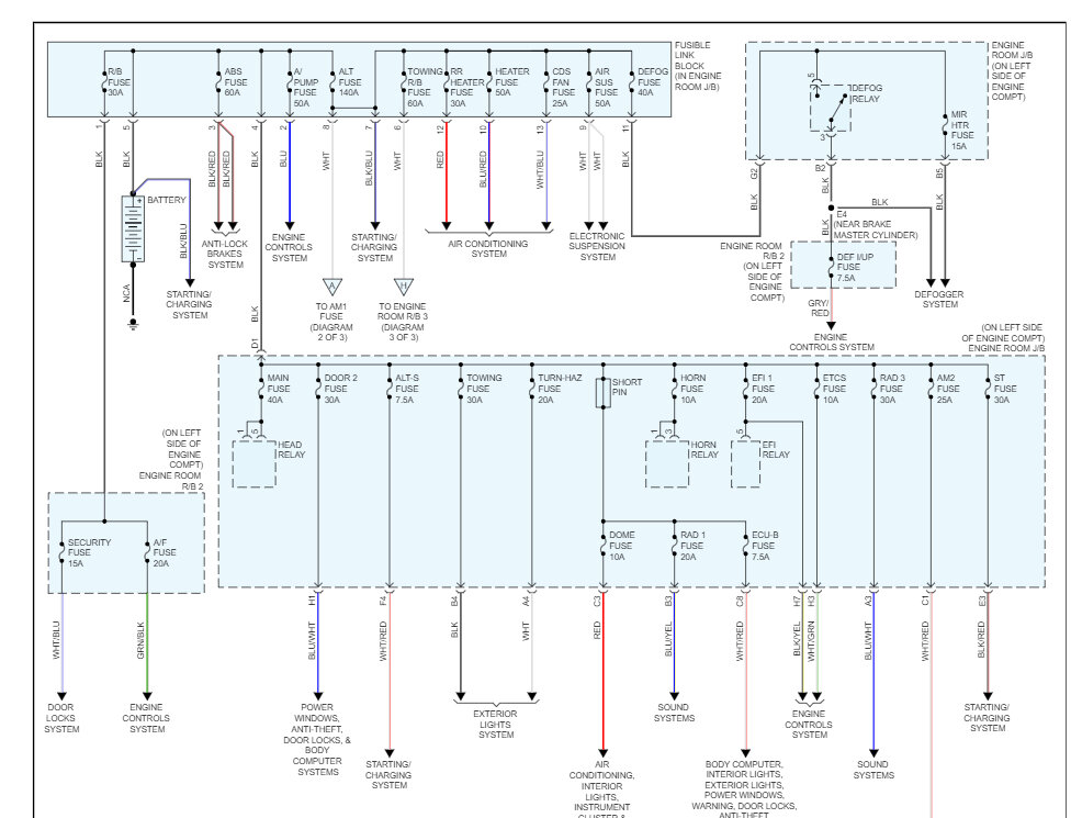

Also, I would check the fusible links this guide can help, and I have included a wiring diagram so you can see which links to check.

I see an accessory relay that I would check or swap out. This relay should be inside the vehicle in the interior fuse panel.

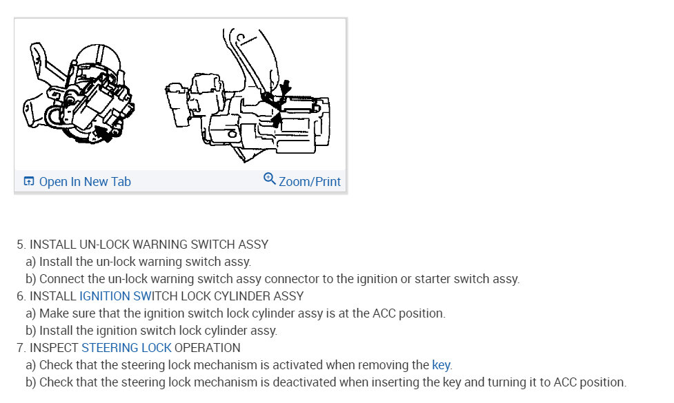

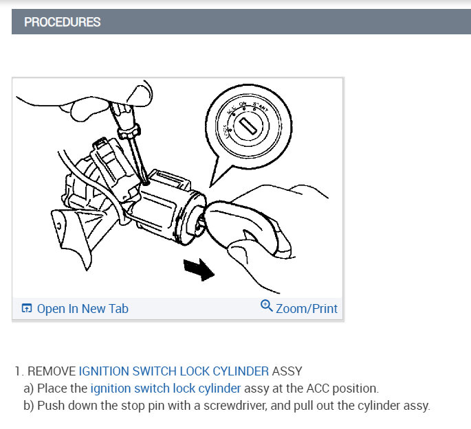

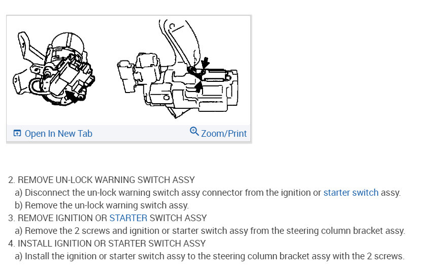

Excellent, it sounds like you have a good handle on it, if you need any instructions or help, please let me know. Here is how to change the lock/switch out.
