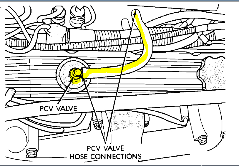

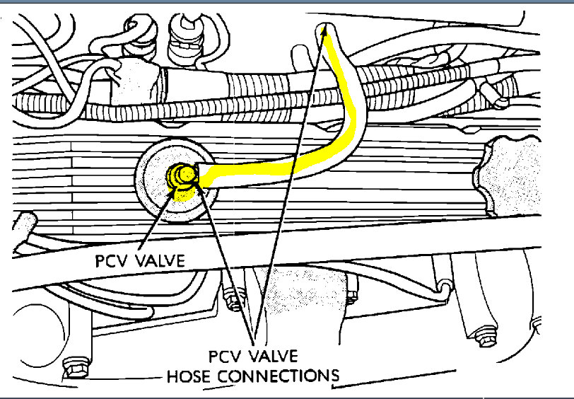

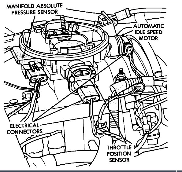

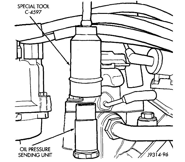

We need to determine where the hissing sound is coming from. It is likely a vacuum leak. It has been a while, but I know this truck doesn't have a mass air flow sensor. However, in its place is a MAP sensor (manifold absolute pressure sensor). That can be throwing things off if unmetered air is getting into the engine. It's mounted on the throttle body. See pic below. Also, check the PCV valve and hose. It runs from the valve cover to the intake. That can create a large leak. See pic 2 below.
Try the procedure I attached above and let me know if you find anything.
See pic below.

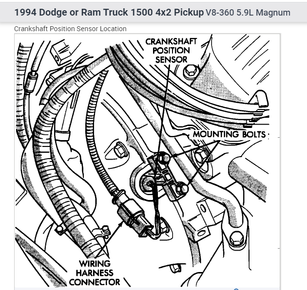

I didn't realize it stalled and you had to wait for 30 minutes. I thought it lost power. Now that I know that, to me it sounds like you have a faulty crankshaft position sensor. When they begin to fail, often heat adversely affects them causing a loss of spark to the plugs. Once they cool, they can work again.
Interestingly, this can happen and not set a code. Do me a favor. Take a look at this link and let me know if it mirrors what you experience:
When the engine stalls and won't restart, I need you to check for spark at the plugs.
Here is a link that explains how to check:
https://www.2carpros.com/articles/how-to-check-for-ignition-spark

Definitely sounds like the CSS... Which really sucks because my mechanic did mention that a while back. My husband doesn't know what I just read and thought it was for something else. So, he disregarded it. But the mechanic didn't explain it properly to me as well. Misinformed. Grrr
Jul 18, 2023 at 2:47 PM
  • 110,244 POSTS

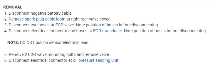

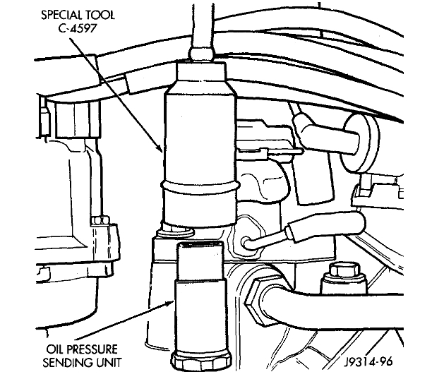

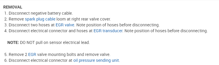

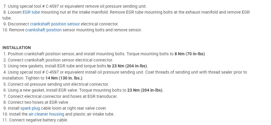

As far as the sensor, if it is the cause, there will be no spark to the plugs. Also, if you have a tachometer in the vehicle, it won't move at all when cranking. If you have a live data scan tool, which your mechanic should have, there won't be an RPM signal when it won't start.
Let me know what I can do to help. Note: This sensor is located on the transmission bell housing. I don't know if you want them, but I attached the directions below for replacing the sensor.
Let me know if this helps.
