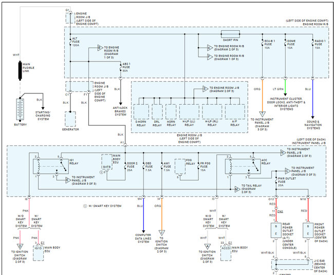

dogs eating all the wires coming out the fuse box?
2011 TOYOTA CAMRY
268,000 MILES • 2.4L • 4 CYL • 2WD • AUTOMATIC
MACJJ74GD
The dogs eating all the wires coming out the fuse box under hood so I need to know the color of the wires and what they connect back to so I can fix my car and get it running its all the wires that go to the headlights, turn signals, fans, washer fluid box, fog lights, and horns. I have another wiring harness off a different model but all the wires are different colors so I need to know the colors of my wires that go to what so I can fix this. thanks
Nov 14, 2024 at 10:52 PM
  • 54,832 POSTS

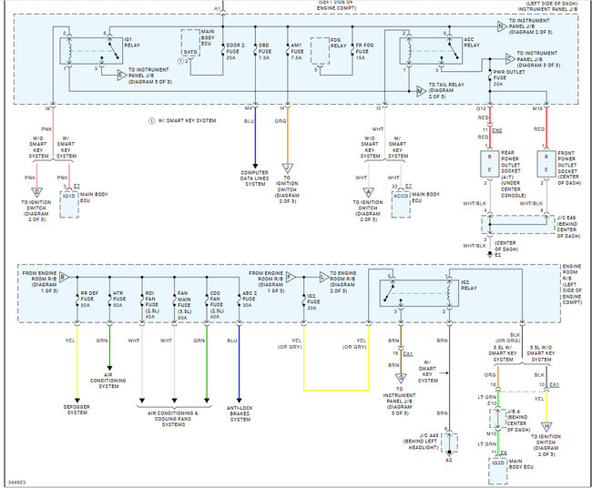

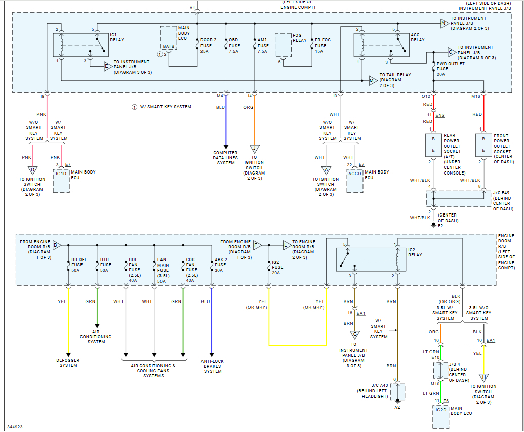

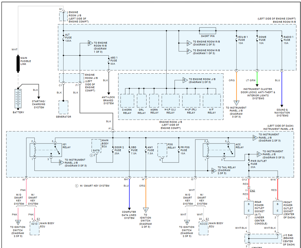

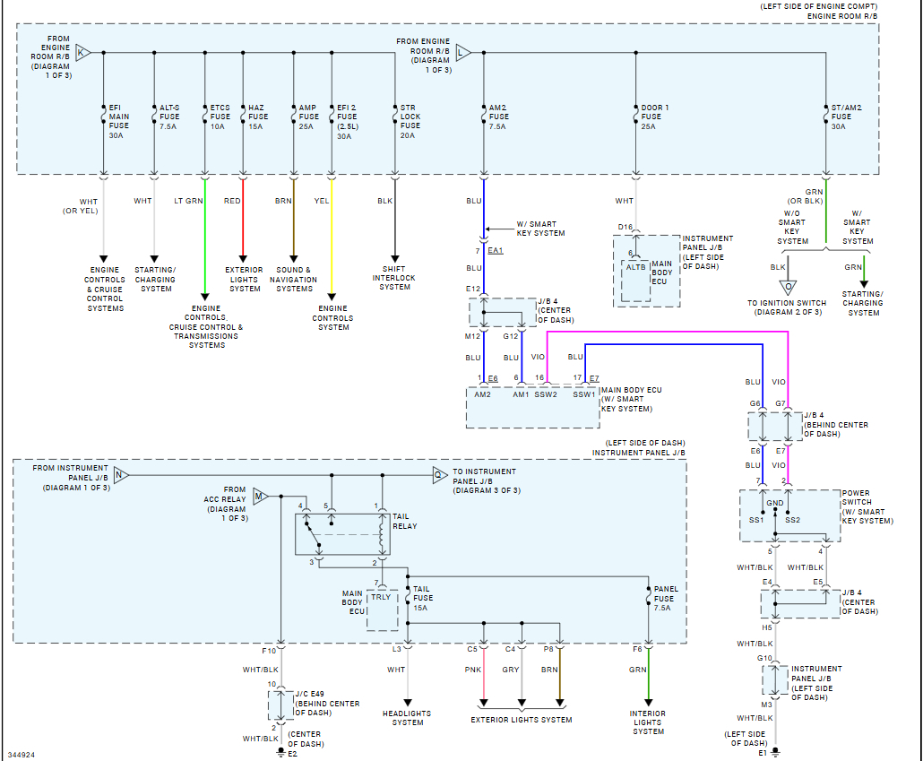

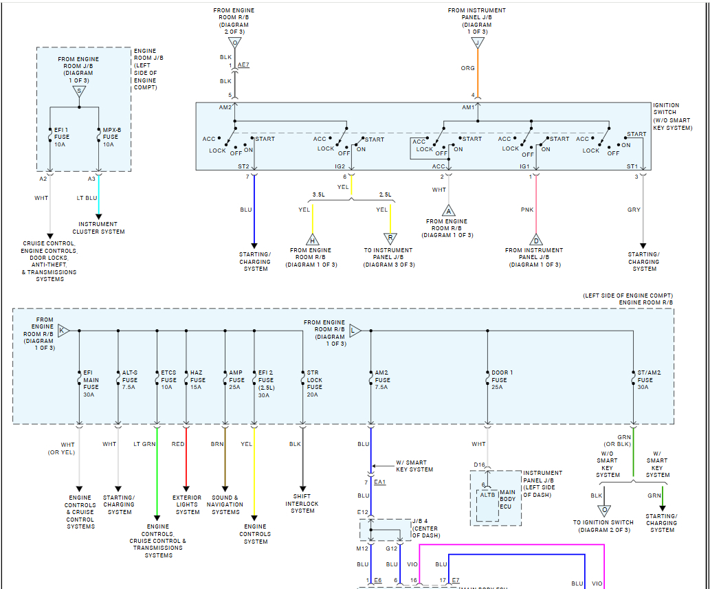

Here are the wiring diagrams for the fuse panel under the hood, please make new questions for the other systems you need wiring for. This guide can help you test the connections as well. You say 2.4-liter engine which is a hybrid model? Here are the diagrams for the 2.5 liter:
Check out the images (below). Let us know if you need anything else.
