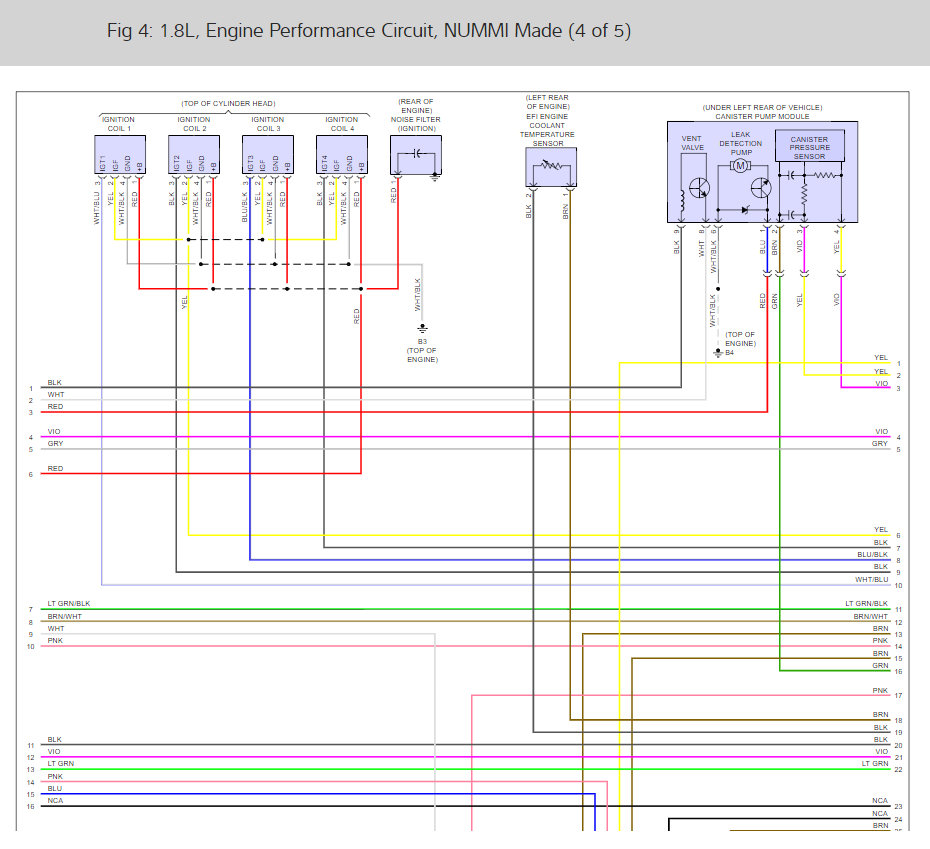

First time I have p0136 and p0138 codes I changed downstream o2 sensor (denso), clear code. light coming back p1201 and p0138 codes. then I change to Toyota OEM part o2 sensor, clear code. light coming back show only p0138 code now. can I fix this myself? previously I was having the Toyota dealer to install and I pay the labor charge only. I do not want to pay diagnose fee ($136.00). Today I drop off to my close mechanic near my house, they said bring it to dealer to reprogram the computer due to your sensor high voltage. please teach me how to fix it with myself?

From the research I have found is that this issue is only corrected by the dealer or if you find a shop that has the equipment and knowledge on how to calibrate the PCM (power-train control module). There is known issue that Toyota is aware of with this code. You replace the sensor and you must also install a new software in the computer. Here is the TSB# (T-SB-0066-10).

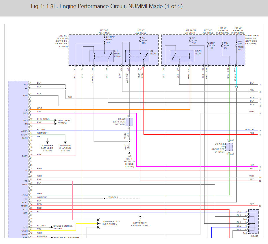

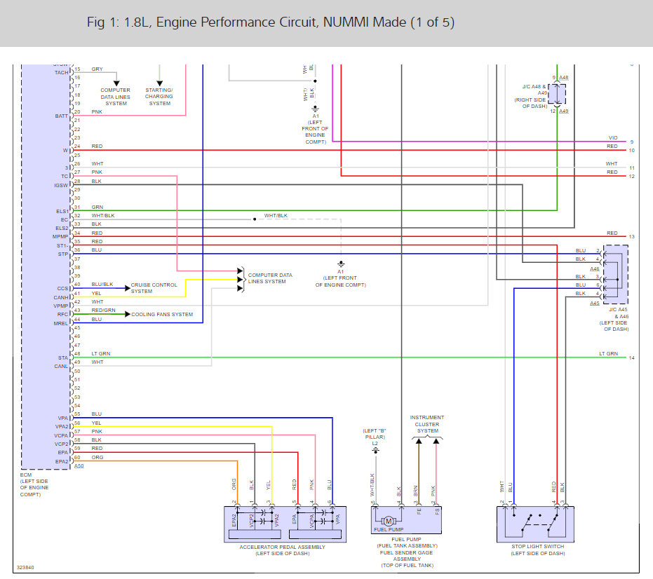

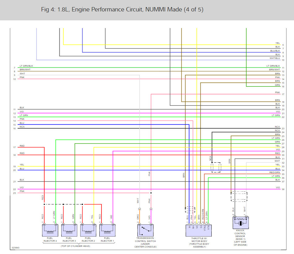

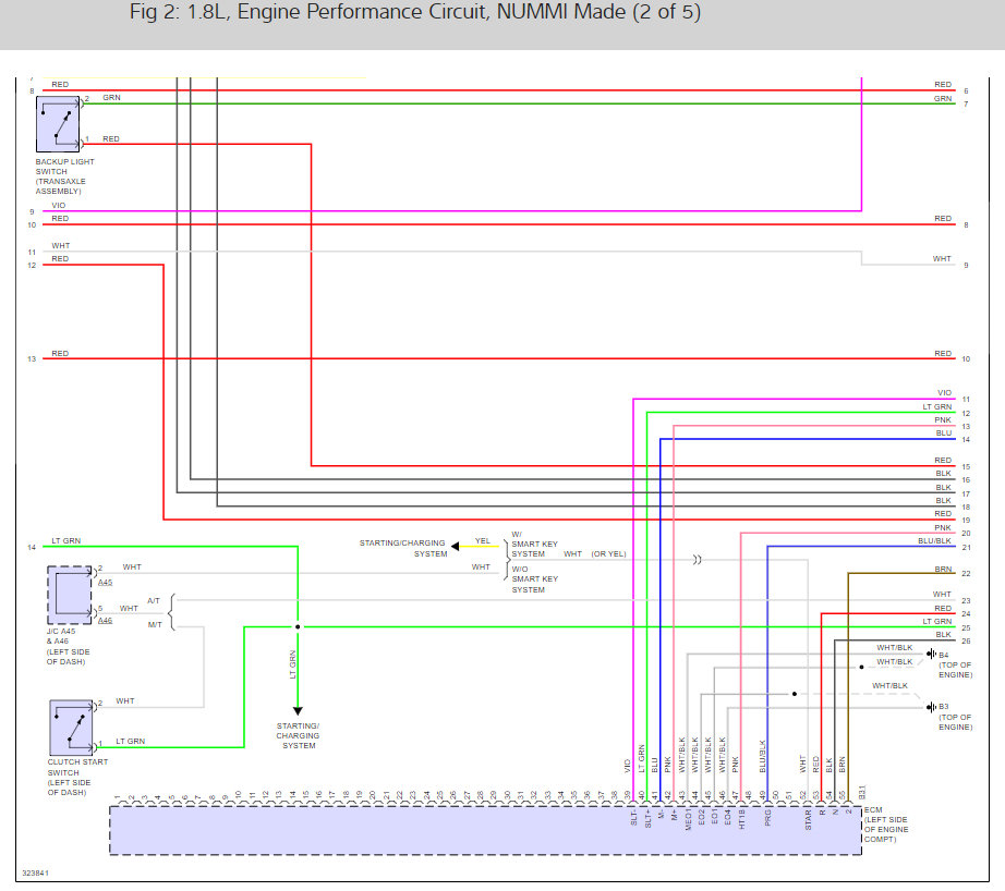

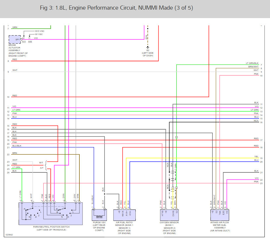

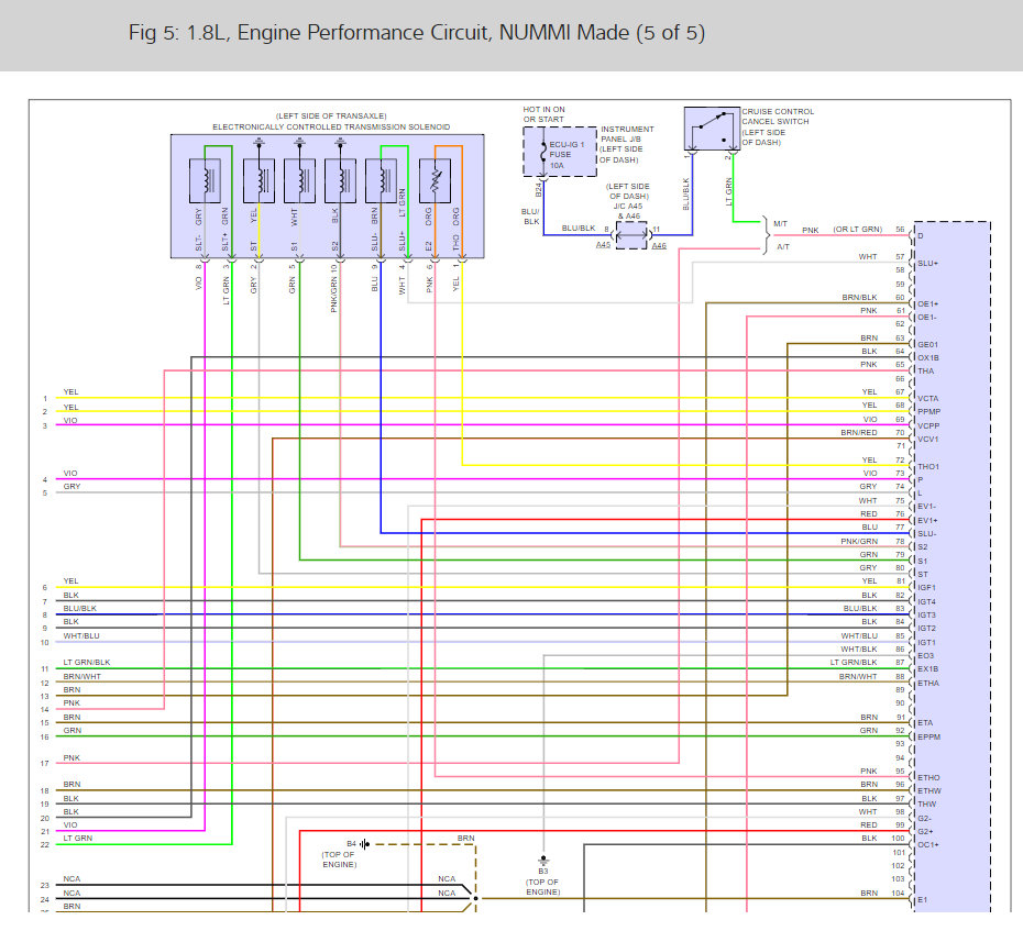

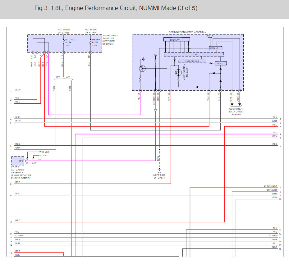

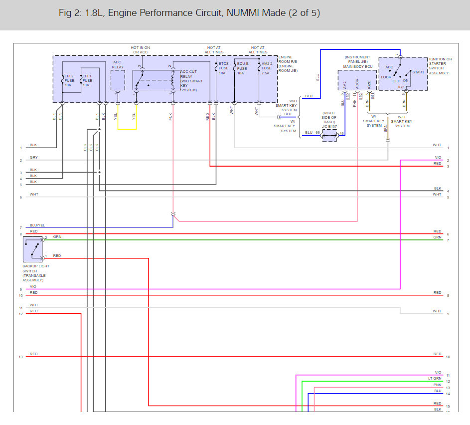

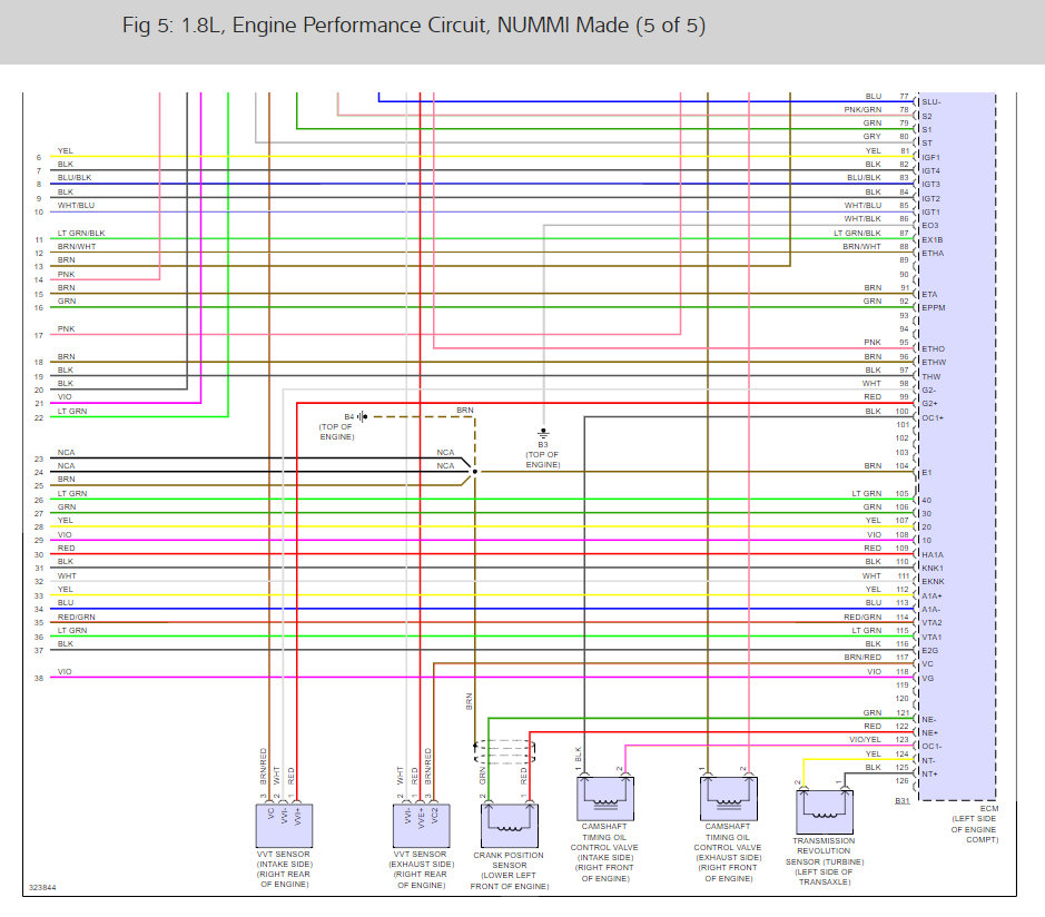

I would check the wiring and connections first. Here is a guide and the engine wiring diagrams so you can run tests:
If the wiring checks out you will need to have the PCM reprogrammed for about $130.00.
Here are the engine wiring diagrams.
