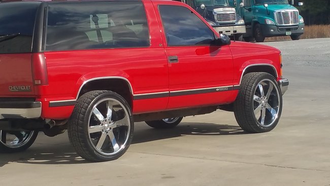

MICHAELMYERS
96 TAHOE
Friday, April 1st, 2016 AT 1:10 PM
HMAC300
  • 48,601 POSTS
Why did you send th pic I know what they look like. If you know the difference between an LS engine and a small block 350 then you can hook everything up and run the 96 setup in it.
-1
Friday, April 1st, 2016 AT 1:14 PM
MICHAELMYERS
If you read the question, it clearly ask do I need anything from 99 tahoe to run in 96 tahoe? As far as the picture, the caption ask for a picture, by kno means was I sending it to you
