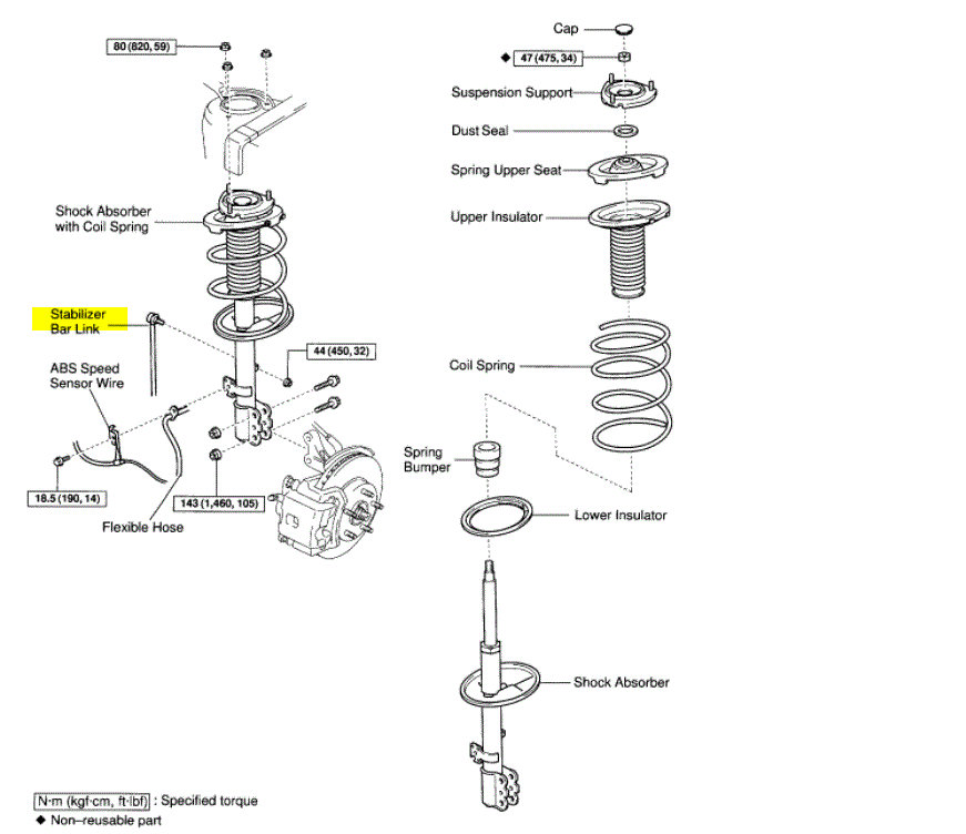

Thanks so much for your attention. Over the past few months, anytime I drive, the back of the car shakes when I turn corners or go over rough roads. My mechanic examined the car and said he said he had to change the rear lower control arm bushings. And the stabilizer linkage.
Afterward, the car no longer vibrates when it turns a bend, but now vibrates toward the front when i go down rough road.
What could possibly be wrong? Also no leakage from the struts or shock absorbers.

The idea that it vibrates can be from several things. Does it seem to happen at a specific speed or is there anything that prompts it to happen? For example, do you feel it when the brakes are applied or it stops when the brakes are applied?
As far as the front suspension, if it seems like a rattling, check the stabilizer links to see if one is loose or broken. I attached a pic below showing the location.
Interestingly, this could be something as simple as a tire balance issue or a bent rim. When it happens, do you feel it in the steering wheel?

Good morning. No it doesn't occur when the brakes see applied. It occurs at a lower speed erratically and on rough road. If the road is smooth, it doesn't occur. It is very uncomfortable but I don't feel it in the steering wheel.
I had done the tire balance a month ago.
After i noticed these problems yesterday, I checked the tires and did a repeat alignment. Then a tire tech tightened the lug nuts on the left front tire, and checked pressures. No more vibrations down the front but more now more of a lateral bouncing movement on rough road.

If you experience bouncing, it sounds like a weak shock absorber. Although there are no leaks from them, they can become weak.
Since you had the vehicle realigned, I have to assume the tech checked all steering and suspension components.
If you bounce the front of the vehicle aggressively and then stop, does it stop bouncing within 3 bounces?
