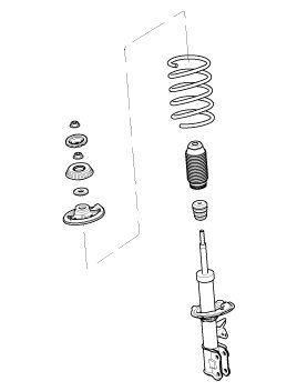

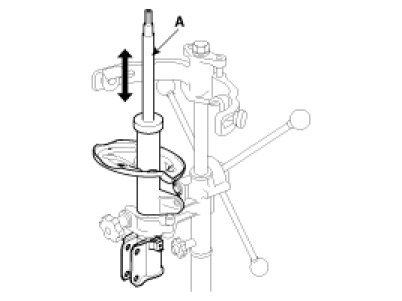

I am replacing the front struts. After I moved the spring and mounts over, I re-assembled it in the vehicle. I went to test drive it and I hear the spring popping. I took the strut back out and the spring had dislodged at the top. I re-installed the spring and then reinstalled the strut and test drove it and it did it again. What do you think I am doing wrong?

1. Compress the coil spring with a strut spring compressor. Do not compress the spring more than necessary.
2. Loosen the lock nut.
Tightening torque :
58.8 - 78.8N.m(6.0 - 7.5kgf.m, 43.4 - 54.2lb-ft)
3. Disassemble the components of front strut assembly in sequence.
pic 7
4. Reassembly is the reverse of disassembly.
Inspection
1. Check the components for damage or deformation.
2. Compress and extend the piston rod (A) and check that there is no abnormal resistance or unusual sound during operation.
pic 8

Thanks Joe! I did finally figure out what I did wrong. I put the top plate that the spring contacts upside down! Well, there were grooves there that the spring fit nicely into. Picture 7 helped a lot! Thanks again!
