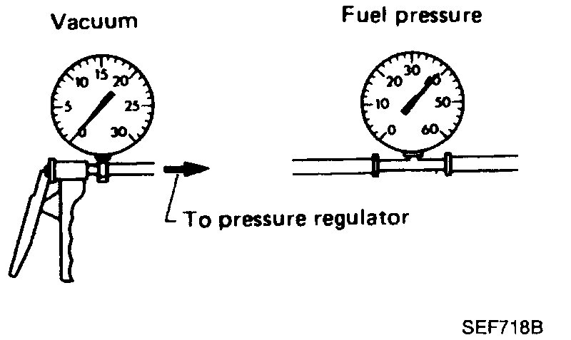

I can crank up my vehicle for the first time of the day and it will run good but then when I shut it off and then crank it back up it shuts off 2-3 seconds after. And it decreases speed when I go up a steep hill. What will cause this to happen?

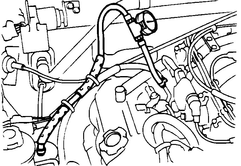

1. Release fuel pressure to zero.
2. Disconnect fuel hose between fuel filter and fuel tube (engine side). Then install pressure gauge.
3. Start engine and check for fuel leakage.
Fuel Pressure Gauge
pic 1
4. Read the indication of fuel pressure gauge.
pic 2

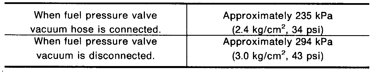

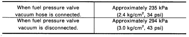

SPECIFICATION AT IDLING
5. Stop engine and disconnect fuel pressure regulator vacuum hose from intake manifold.
6. Plug intake manifold with a rubber cap.
7. Connect variable vacuum source to fuel pressure regulator.
Vacuum/fuel Pressure Test
pic 3
8. Start engine and read indication of fuel pressure gauge as vacuum is changed.
NOTE: Fuel pressure should decrease as vacuum increases. If results are unsatisfactory, replace fuel pressure regulator.
