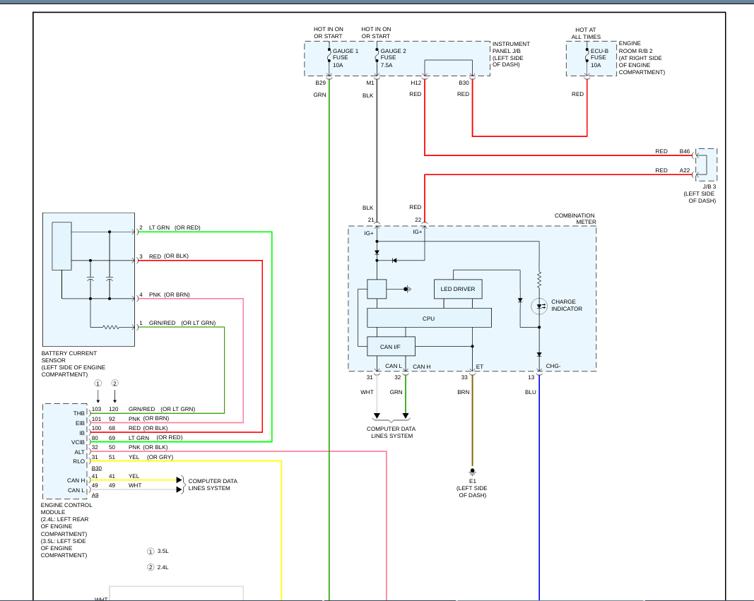

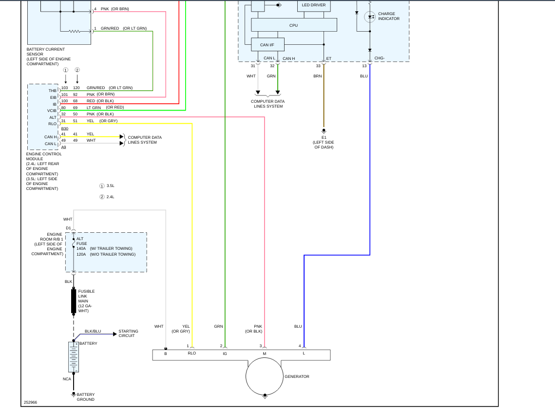

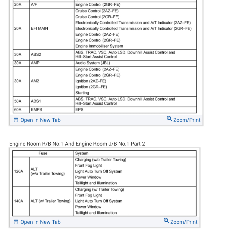

Anyone know how to check voltage signal from ECM or how to check ECM? We have good alternator it was bench tested and we have 12 volts at alternator also.

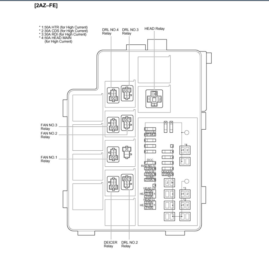

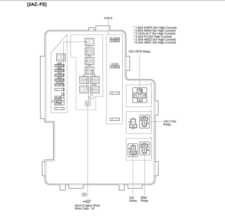

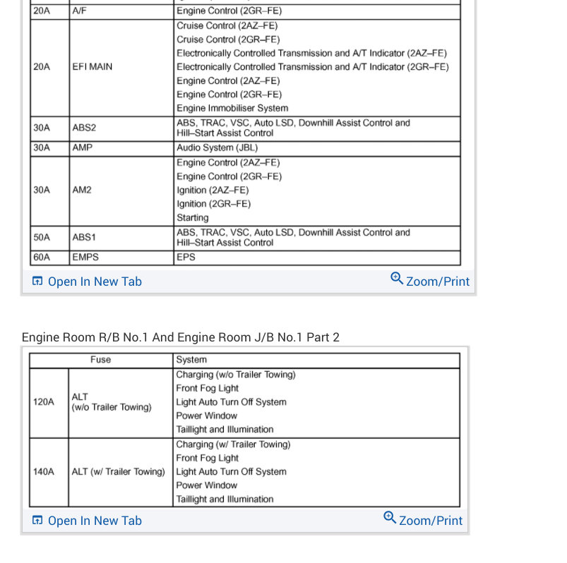

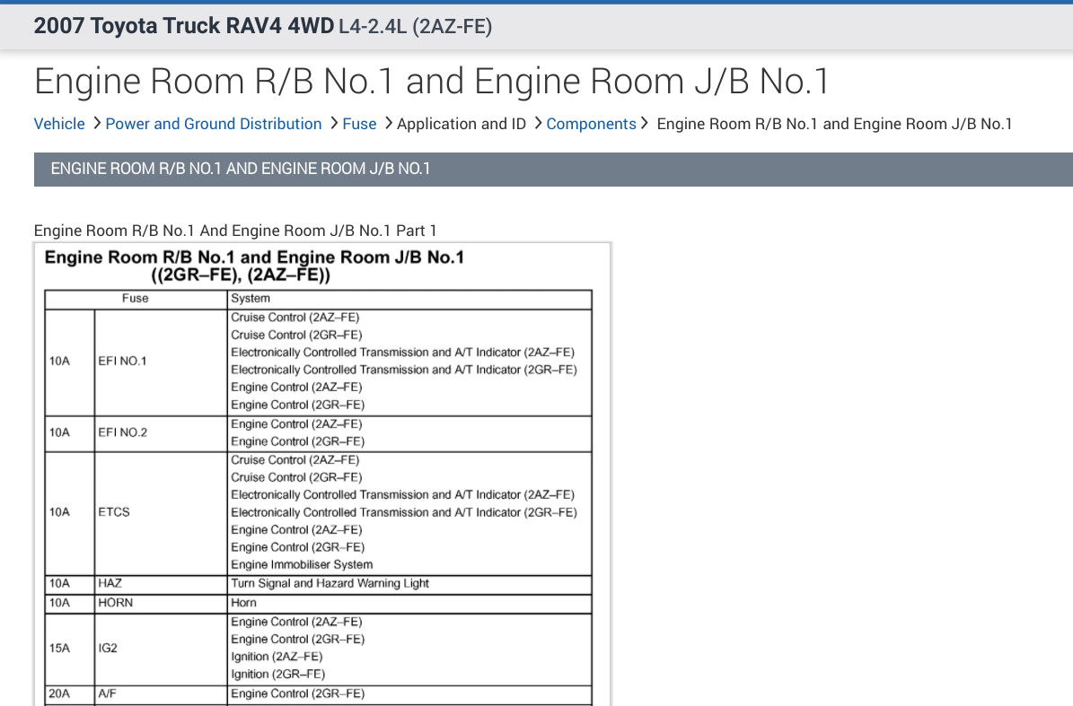

I would start by checking the ALT fuse[120/140A] in the Engine Room R/B 1 on the left hand side of the engine compartment. In the diagrams down below I have included the Charging circuit wiring diagram and the diagram of the Engine Room R/B 1 with call out for you in the diagrams down below. Here is a link explaining how to check a fuse, if needed, below as well:
Please go through these guides and get back to us with what you find out. We can go from there, if needed.
