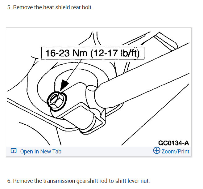

What size is the bolt or nut that holds one of the round shifter rods to the transmission the gears still shift but one of the rods is resting on the cross member.
Mar 11, 2025 at 6:45 AM
  • 55,394 POSTS
If it is the bolt in the image below it will be 13mm. Can you please upload an image so I can see if I got the correct one? Check out the images (below).
