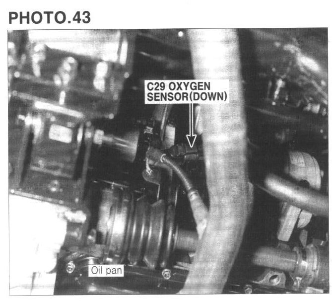

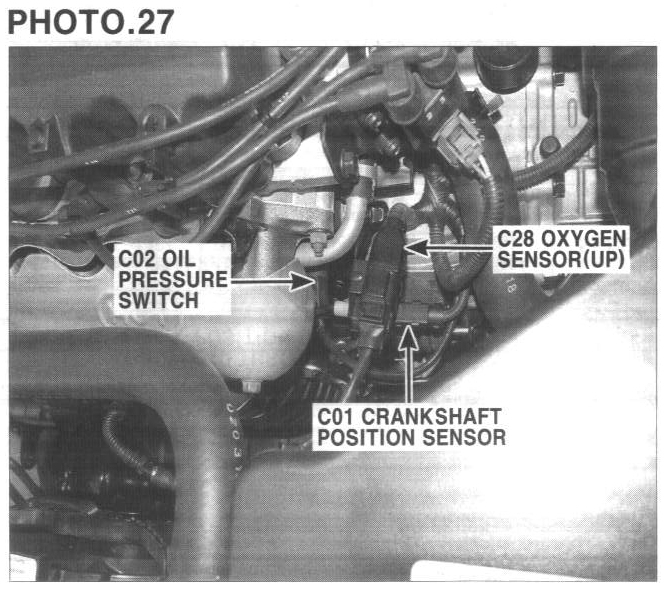

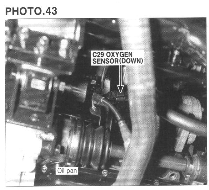

Your video is of the flywheel and connector plate. That is what connects the transmission internally with the engine. Any idea what that was hitting? Also, make sure all bolts are tight.
As far as the o2 sensors, there is an upstream (see picture 1) which is the heated sensor and there is a down stream (see picture 2) sensor. I am not sure why it is saying bank one and two. Can you send me the codes you are getting?

The code was p0135, p0145, p0758 and then p0135. Again it said both downstream and upstream o2 sensors need replaced and as far as what the flex-plate is hitting I do not know. I think it is just the serrated edges or hitting against that side the transmission when it goes in a circle.

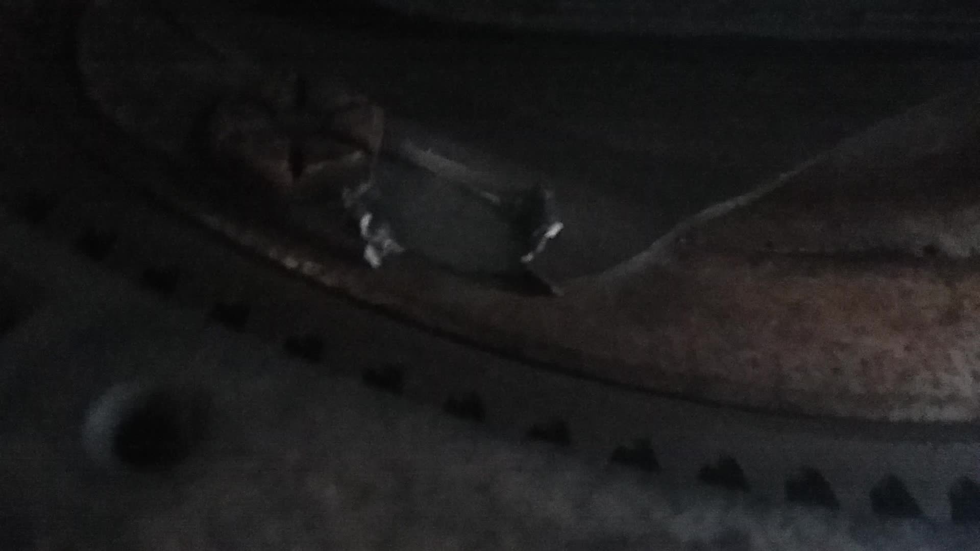

I did get under the car and I could see what was going on. I was able to get down and actually turn the flex plate because it was split. So I fixed it and now it runs fine and there is no noise. So thank you for your help.

By the way, what did you find regarding the flex plate?
