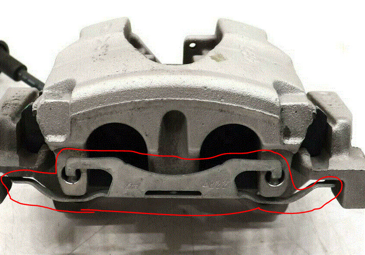

When driving on a bumpy road I hear this distinct rattling noise but if I gently apply the brake pedal while still moving the noise stops. If I release the pedal it continues. Shops have done a visual inspection and saw nothing loose. Please advise of what this possibly could be.

If you apply the brakes and the noise stops, it sounds brake-related. If you look at the pic below, I circled a caliper pad spring. Make sure they are all present, fully attached, and not broken.
Let me know what you find.

Is this the pic of the front caliper?

That pic is a Mercedes front caliper, but I'm not sure what model you have. I know it's a GLK, but is it a 250 Bluetec, a 350, or a 350 4matic?
