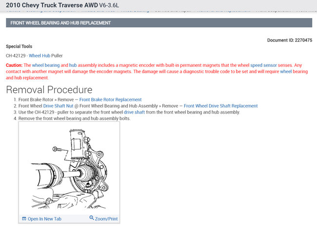

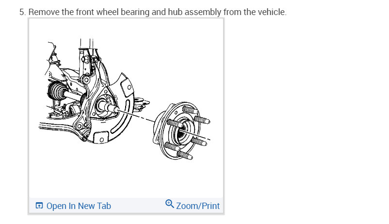

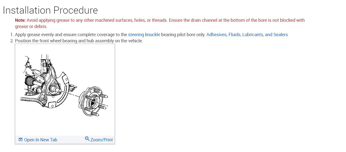

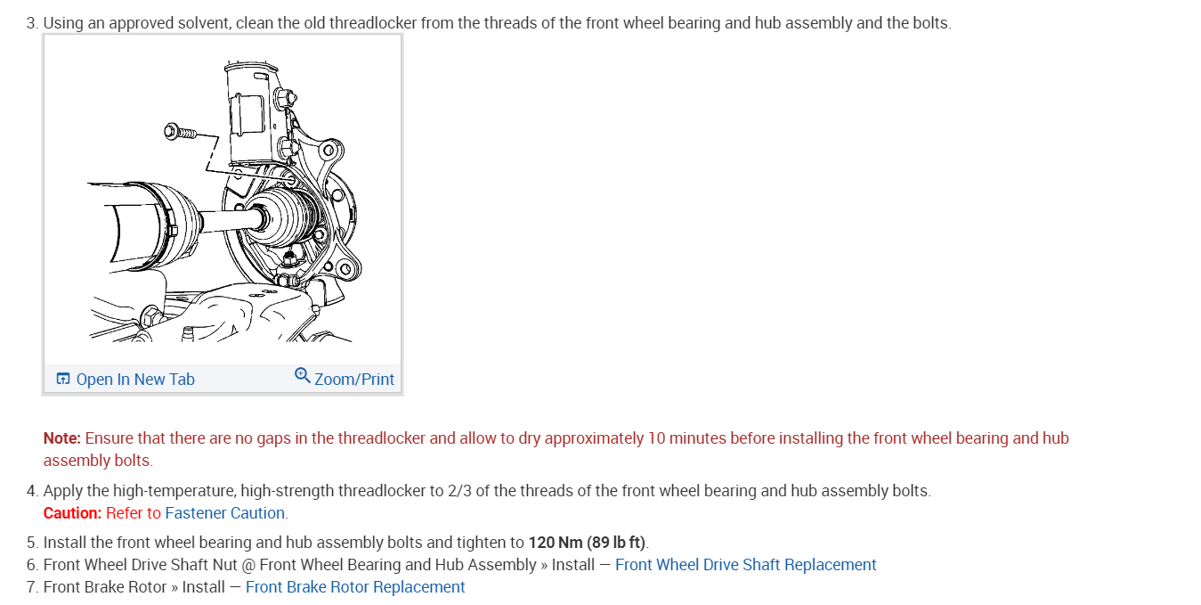

Thanks for the video. Is the noise coming from the front, left or right side? If so, it sounds like the bearing hubs in the front need to be replaced. Here is how the job is done and the part needed on Amazon:
https://amzn.to/44JrQFs
Check out the images (below). Please let us know how it goes.
