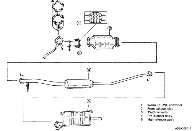

Rattling when idling or accelerating
2002 KIA SPECTRA
170,000 MILES • 1.8L • 4 CYL • 2WD • MANUAL
DANIEL INGRAM
Anytime I'm idling or accelerating I hear a rattle sometime IRS louder when just idling, but mainly while driving. it's a five speed at first thought it was a cover but now not so sure.

Most times, the heat shields on the exhaust come loose and rattle. To this. Take a rubber mallet and tap on the exhaust on the vehicle to see if you can recreate the sound. The most common one to rattle is the one covering the catalytic converter, number 3 in the attached picture. Also, check any of the clamps on the exhaust which can rust apart and then dangle and rattle.
Let me know what you find.
