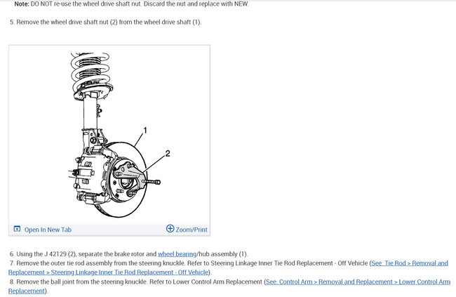

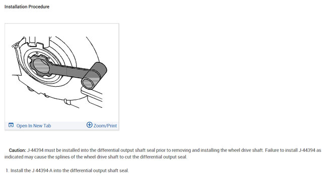

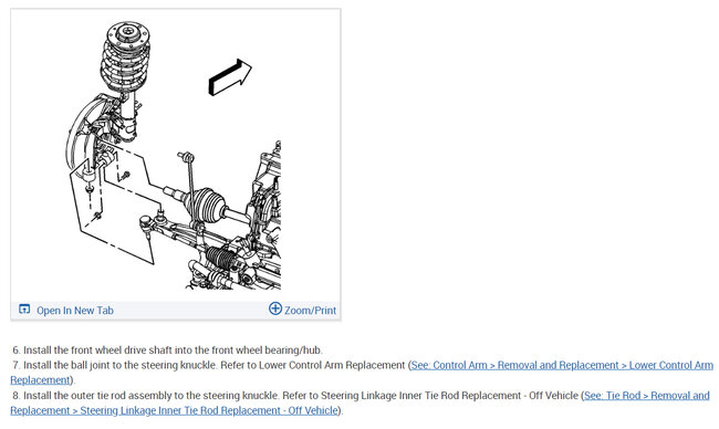

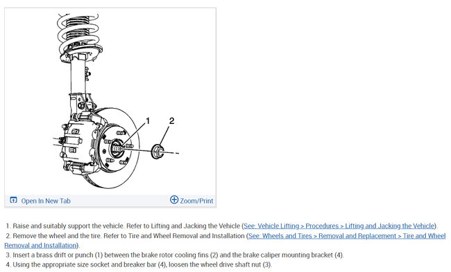

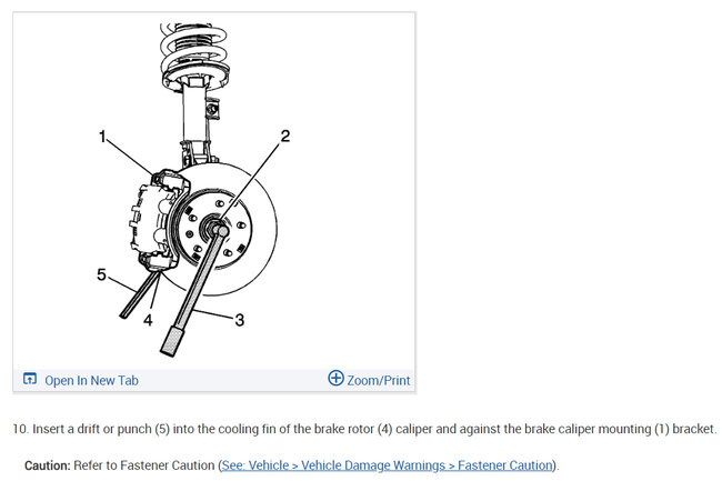

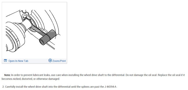

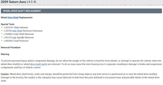

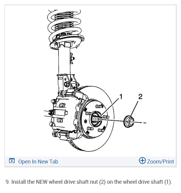

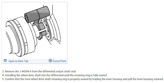

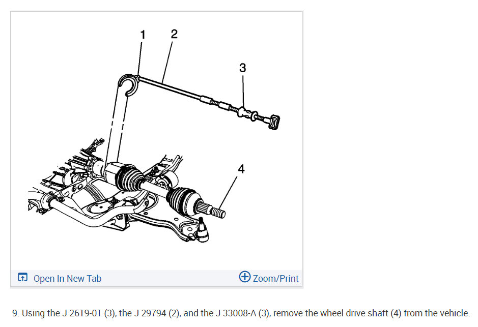

Okay, we need to put the car in the air and do an inspection. While in the air I would put the car in drive to watch of the drivetrain. It does sound like the CV axles are bad though, have they been replaced? Here are the instructions to let you know how to do the job or see what needs to be done when they are bad. Check out the images (below). Please let us know what happens.
