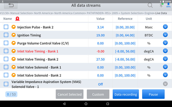

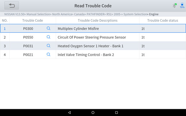

I have replaced used actuator but the noise still remains, I replaced used cylinder head but still remain, I serviced the replaced actuator and put back, it still remains with P0021, from the live data of inlet valve bank 1 and 2, is it that timing is not correct or the oil control valve or the ECM?
I have shot the video, I uploaded the video, the screenshot of live data and screenshot of fault code that return.

The engine noise seems like the timing chain guide is broken or you have a broken piston. Also, the P0021: timing over-advanced or system performance (Bank 2) seems like the camshaft timing is off. Can you please recheck it?

Did you take time to review the Live Data Streaming I sent to you to see whether the inlet valve timing -9(-8.00;56) bank 1 and bank 2 27.56(-8.00;56) are not corresponding?
Also, the P0021: timing over-advanced or system performance (Bank 2) seems like the camshaft timing is off. Did you mean rechecking the timing marks on engine to see whether it all aligned with chain marks? If yes, I will tell you that I have checked that more than 5times using timing diagram from all data repair software.

I wanted you to recheck the timing. Have you done a compression test? No, the engine starts at a crank.
That -9 is for inlet valve timing bank 1, which is not showing fault code, Then the (-8.00,56) is the correct valve timing parameter inlet valve bank 1 n'2.
Therefore, inlet valve timing parameter for bank2 is 27.50 but showing fault code while bank1 is -9 but not showing fault code, which one is correct among the two?

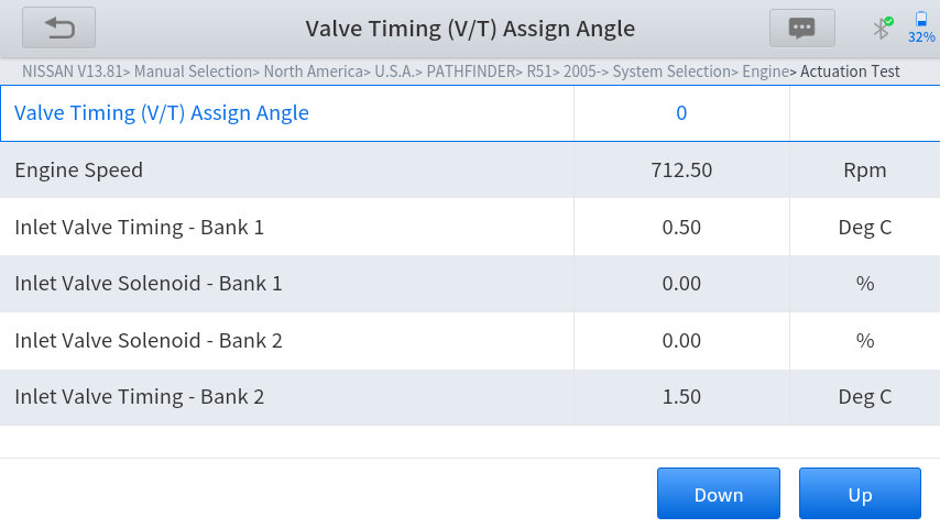

So far so good, I interchange the VVT Actuator from bank2 to bank1 and P0021 changes to P0011. I replaced the VVT actuator for bank1 and that fault code disappeared, but the rattling noise reduced remaining small.
Then the valve parameters for inlet valve timing bank1 drop from -9 to 0.5CA and bank2 drop from 27.50CA to 1.50CA.
Therefore, I still need to replace VVT actuator for bank2 and see if these valve parameters will correspond to 0.5 CA (camshaft angle) and eliminate the small noise remaining.
I attached the screenshot of live data of valve parameters after VVT actuator replacement bank1.

Thanks for getting back to us on this, you are correct the bank2, so you need to replace VVT actuator.
