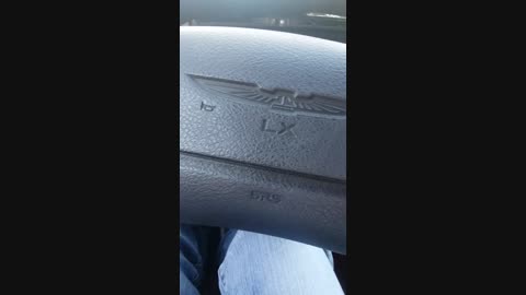

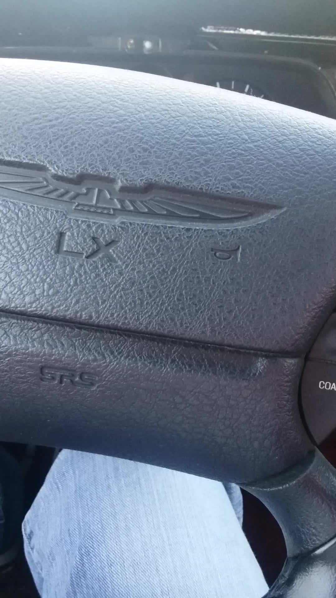

Here you go:
Nov 27, 2018 at 5:30 AM
Sorry. That is an internal engine noise. You need to have that checked as soon as possible.
Nov 27, 2018 at 5:47 AM
SURGEIMPULSE
  • 67 POSTS
Ugh! Guess I will probably need to replace a connecting rod bearings, if not swap the engine if it is too bad. I will get it checked out. Most likely should just swap it.
