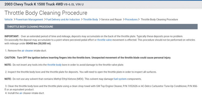

Okay, I will give it a clean. On these trucks it is self-learning after I clean it right?
And all I use in it is premium gas but the last time my brother filled it up he said he didn’t know and put regular in there so that might be the problem.
Thank you
Mar 9, 2022 at 6:26 AM
  • 110,251 POSTS
Yes, it will relearn by itself.
Also, here is a link that explains in general how to service a throttle body.
I attached the directions from my manual below. They are vague. LOL
See pic.
