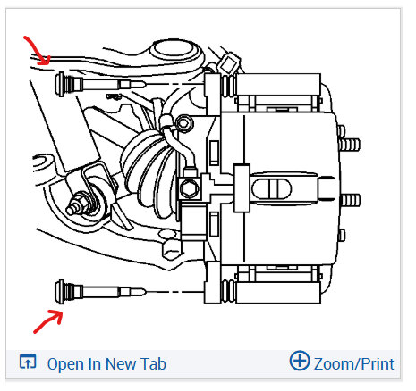

Hi, I’m hearing a rattle/clanking type of noise only when going through cracks or bumps on the road and noise stops when I press on the brake even slightly and does it again when brakes are released so it seems like it is something Brake Caliper related probably but don’t know what exactly could be, also when I brake hard for instance a sudden stop for a red light and basically holding the brake down hard and when I release I can feel like a thump and hear a clank. Hope someone can help me with this, Thank you. Attached below is a video of the noise. I hope it can be heard. You can hear it good halfway and toward the end of the short video.

Yep, thanks for the video. I would remove the tire that is making the noise and check the brake caliper, it sounds like one of the bolts fell out and the caliper is loose, please check the image below to see what I am talking about, also here is a guide as well:
