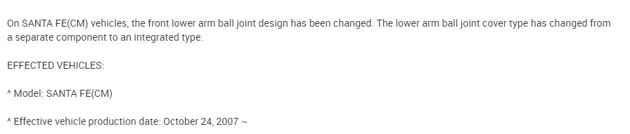

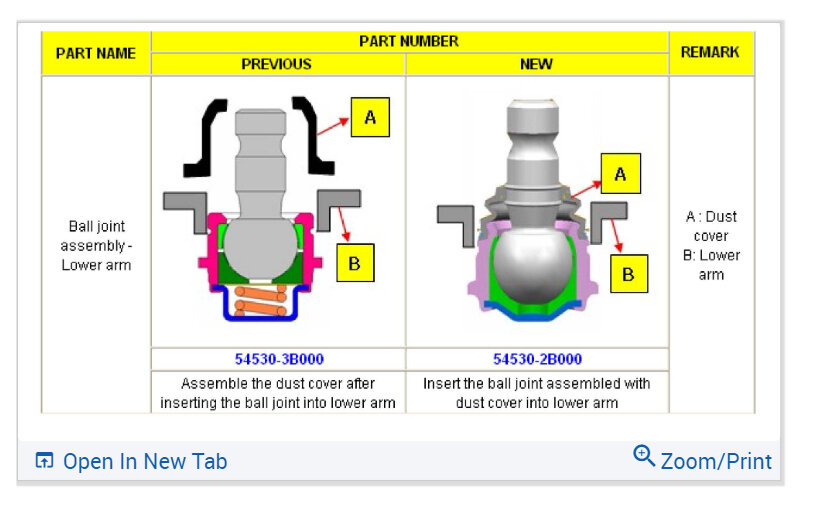

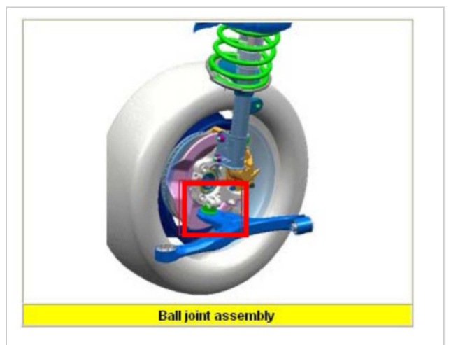

Based on the description, it sounds like the ball joints. Have you lifted the wheels off the ground to check for play? Also, have you had the alignment checked? The tilt of the wheels indicates the wheel camber is out of alignment.

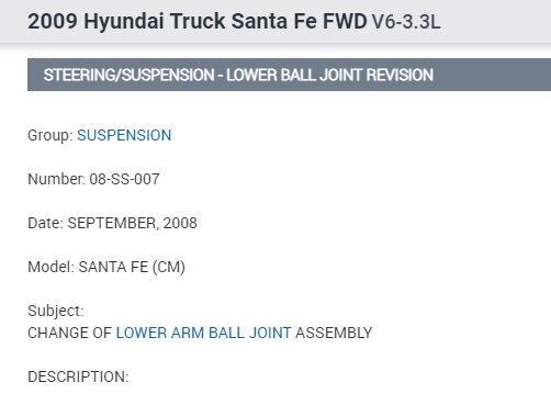

Also, the ball joint design was changed. I attached the technical service bulletin (TSB) below for your review. Take a look at the change that was made and confirm if you used the new style.

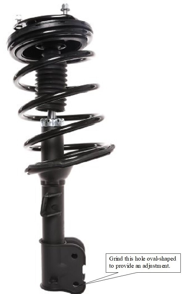

It's when camber is not equal on both sides that one tire's pull will not be strong enough to offset the other tire's pull, then the car will pull in the direction of the higher camber. Here's a major point of confusion. You may have to turn the steering wheel to one side to counteract that pull, but that is not considered an off-center steering wheel. If the steering wheel is straight when you let go of it at higher speeds, it's the camber pull you're counteracting. Since you noticed rapid wear on the inner edges of the tires, if camber is the cause, the tire(s) with that wear is tipped in too far on top. Your car model uses a common strut design with two bolts on the bottom. With Chrysler products, you loosen the bolts, then rotate one of them or just shove the wheel in or out to set it to specs. With GM products and with your model, the first time camber needs to be adjusted, the lower hole has to be ground into an oval to allow that adjustment to be made. Three things can cause camber to need to be readjusted. When repairing crash damage, metal fatigue on older / rusty bodies, and sagged suspension ride height. All alignment specialists measure ride height first because if it's too low, you'll still have bad tire wear even when the alignment numbers look perfect. Sagged ride height is a factor of age, not mileage. It's corrected with new coil springs. To save you time and money, mechanics will often sell you a complete strut assembly as shown in this photo. You get new coil springs as part of the package. You'll pay a little more since you're getting more parts, but you'll more than make that up in the greatly reduced labor time. The vehicle must be aligned when struts are replaced, to set camber back to specs.
