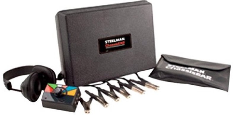

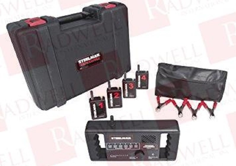

Also, this is a perfect application for a tool called the "Chassis Ear". It's a set of six microphones, a switch box, and headphones. You clip the microphones to suspect parts, then go on a test drive while listening in the headphones and switching between them. I found the original kit on eBay for only $99.00. They normally cost around $200.00 from the guys who drive the tool trucks to the repair shops each week. This set has wired microphones, so you must be careful where you string the wires. A newer model has four wireless microphones, but it costs more.
Be aware a lot of mechanics have never heard of this tool or even seen it. Suspension and alignment specialists use them quite often when looking for the source of rattles and other noises.
If you need to get a specialist involved, the best place to go is to a tire and alignment shop. People at the dealership are used to working on relatively new cars that haven't had time to develop noises yet. The people at alignment shops are experts at finding the causes of noises, vibrations, and bad tire wear.

Consider asking at some local auto parts stores that rent or borrow tools. In my city, they make you buy the tool, then you get a full refund when you return it. If you choose to keep a tool, you still return it, then they order or give you a brand new one.
You may not find this tool for loan because, so few people know about it or ask for it.
As the suspension and alignment specialist at the Chrysler dealership I used to work at, we had this tool supplied to us by Chrysler. I was one out of only two people who ever used it. I used it perhaps once a year, but it sure solved some elusive problems.
