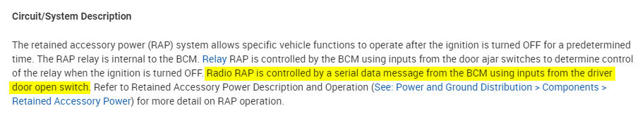

how can i replace the RAP in my truck. My radio lights stay on when shut off the truck.
Nov 25, 2019 at 9:26 PM

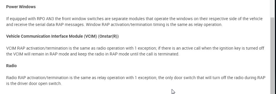

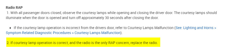

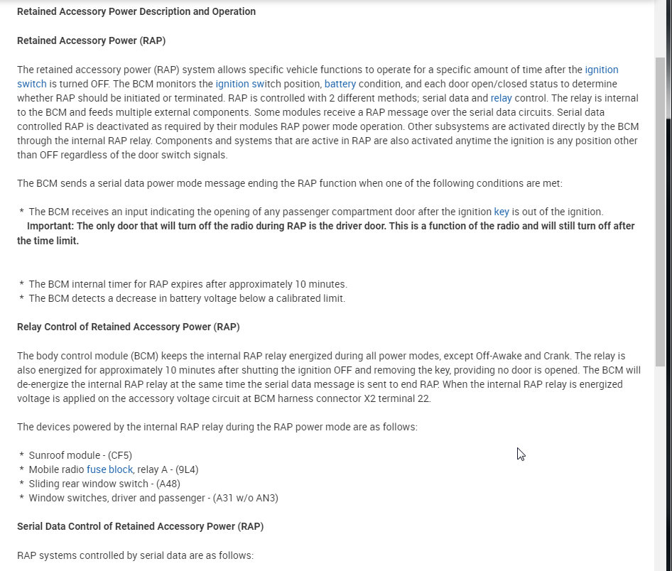

I am not sure I understand what you are after. The Retained Accessory Power (RAP) is an system and not one component. There is RAP relay but that is internal to the BCM.
If the lights are the only concern the radio itself may be the issue. Check out this info and let me know what you think.
