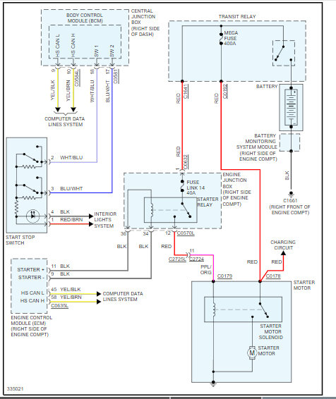

This vehicle started this problem after being pack for seven years and came back to start the vehicle and this vehicle started this problem. what's the cause of this problem?

Because it is a push-button start, the first thing I would do is check for diagnostic trouble codes. Scan the can-bus to see if there is anything stored.
How can you scan a vehicle that when you press the push-button, no light will appear on the dashboard showing that ignition was turned on?
With the new BCM installed and push-button pressed, a light will flash saying "key not found".

When you replaced the BCM, did you restore communication to the CJB and update/program the new module?

Can program a module when the ignition is not turned on, everything I am doing now is for ignition to turn On. Use the ignition diagram to check how to turn ignition on before programming.

I don't know if it will help you or not, but I attached the wiring schematic for the starting system. It appears everything comes from the BCM.
Let me know if this helps.
See pic below.
