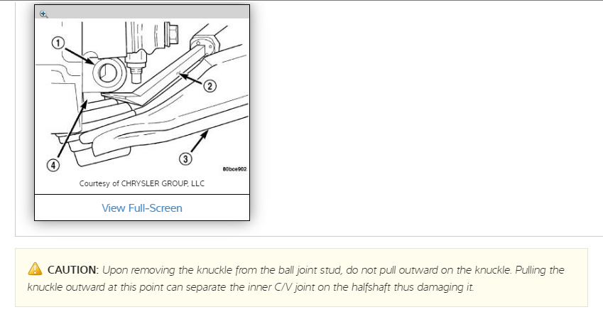

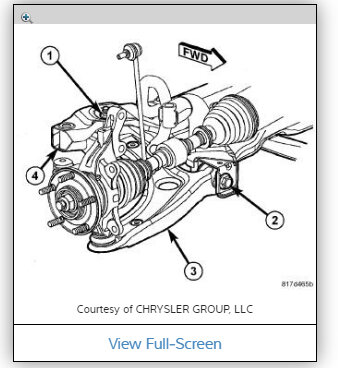

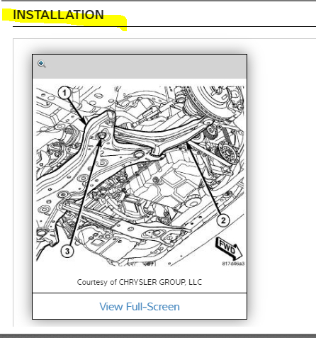

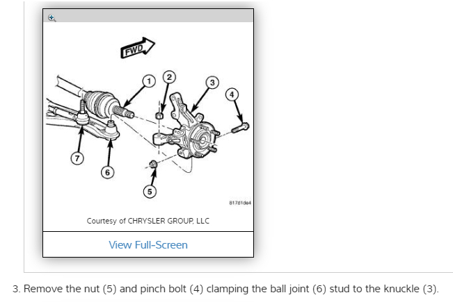

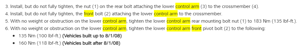

I know what it is, I was just listening to other people again and doubting myself. It's my lower control arm on the driver's side, it jerks to the right or passenger side when I accelerate and then to the left or driver's side when I decelerate. Even though I have always worked on my own vehicles I still doubt myself and let others convince me that I don't know what I'm doing, and they are right. I'm sorry for the long explanation.
Mar 5, 2023 at 1:23 PM
  • 110,248 POSTS

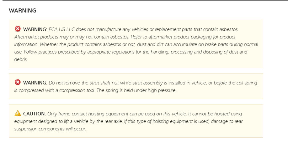

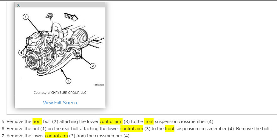

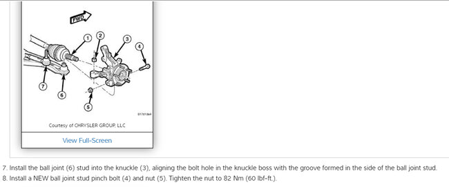

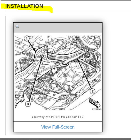

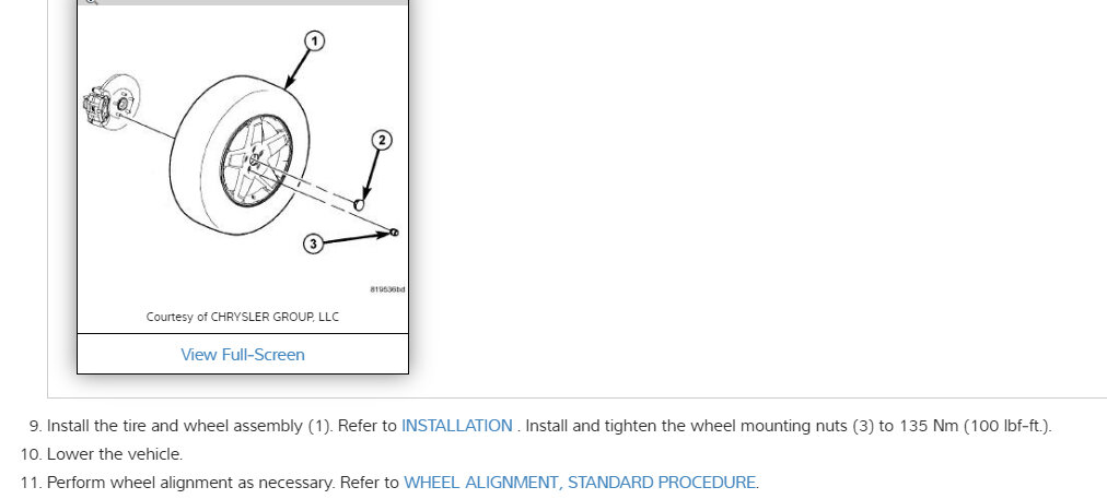

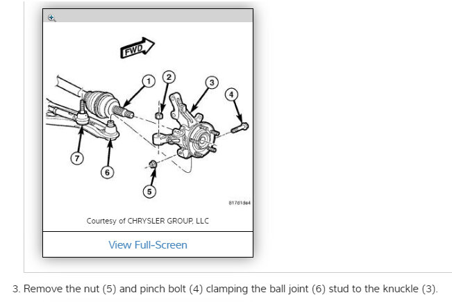

If it is that loose, that is just as dangerous. It has to be wearing the tires.

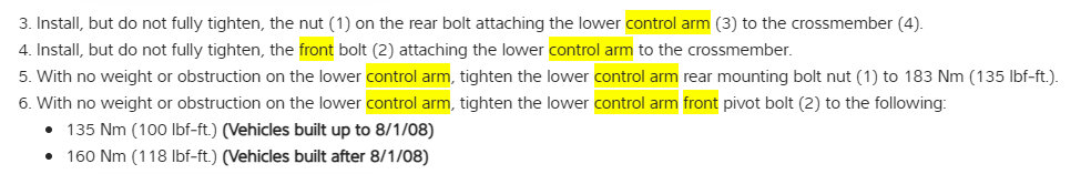

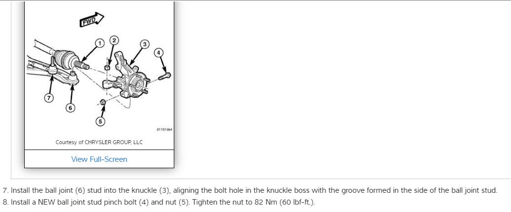

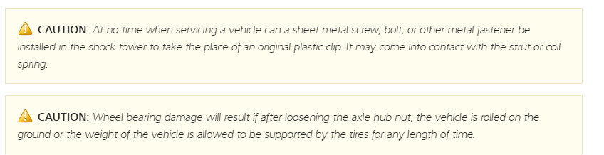

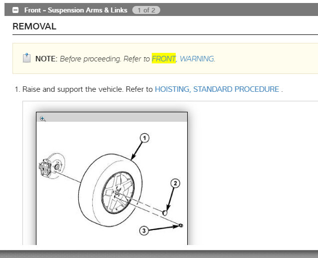

If you look below, I attached the directions for removing and replacing the lower control arm. I believe this is sold as a unit with the bushings and ball joint installed. I know I've tried to replace just a ball joint, and it was basically impossible. LOL
Let me know if this helps you or if you have other questions.
