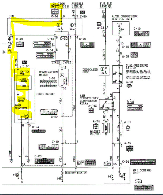

If you had spark with the other "new distributor" but have none now with a different "new distributor", there is a chance the new one is bad. If I recall, the ignition control module and coil are integral to the distributor. Either of them could be faulty.
I attached a pic below of the wiring schematic to the distributor. If I'm reading it correctly, there should be a black/white wire from the ignition switch that sends power to the distributor, so you may want to confirm power is present.
See pic below.

Thanks so much and apologies for the late reply. I got another new distributor with no spark. I verified power on black/white. Do I need to test more pins on this connector? There's also a secondary connector as well as a capacitor of some kind bolted to the distributor. Is there a fuse/link related to any of the other pins going to the distributor? Otherwise, how would I test the ECM? Maybe I've missed something else?

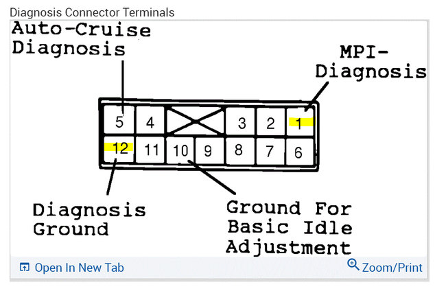

I was unable to retrieve codes. Is there a diagnostic connector I need to jump to enable the retrieval?

Since this was manufactured by Mitsubishi, let's try a different technique for getting codes
Follow this link and let me know the results:
https://www.2carpros.com/articles/mitsubishi-trouble-code-definitions-and-retrieval-procedure-for-odb1-system

You are jumping pic 1 and 12, correct? See pic 1 below.

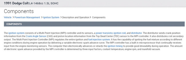

Also, read through pic 2 and let me know if the things discussed have been inspected or tested.
See pic below.
