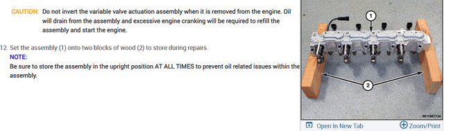

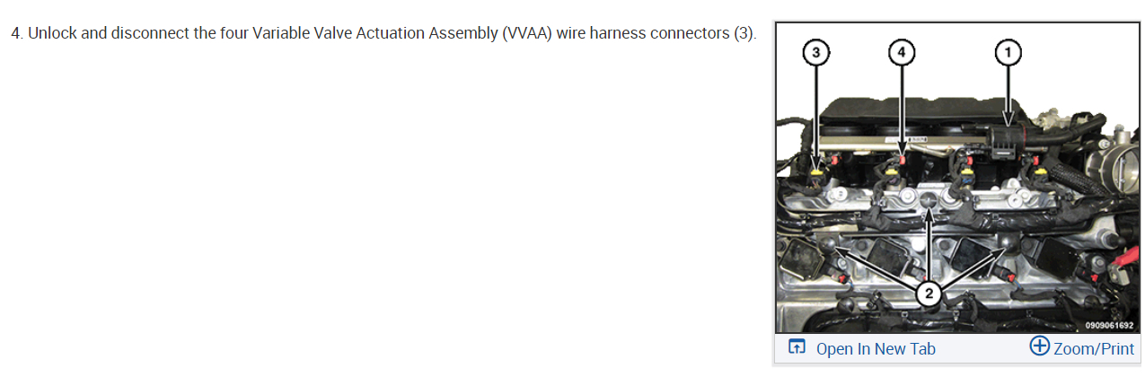

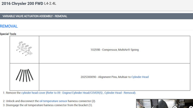

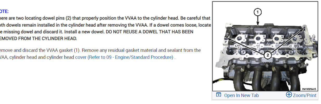

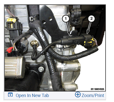

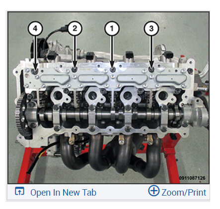

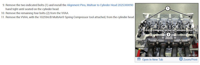

The P1041 code on a 2016 Chrysler 200 refers to Cylinder 2 Oil Supply Solenoid Valve Switch Off Timing Performance. I would replace the battery, but I don't think that is the engine problem. The engine computer and code is telling you the camshaft position is not correct, I would start by changing the oil and filter, this will help the camshaft actuator system. Please go over this guide as well:
https://www.2carpros.com/articles/repairing-engine-rough-idle-issues

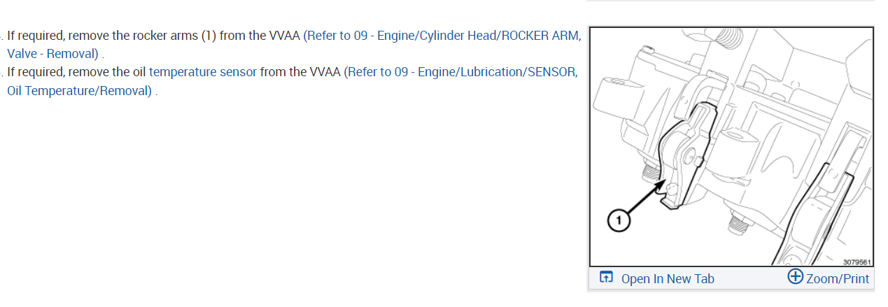

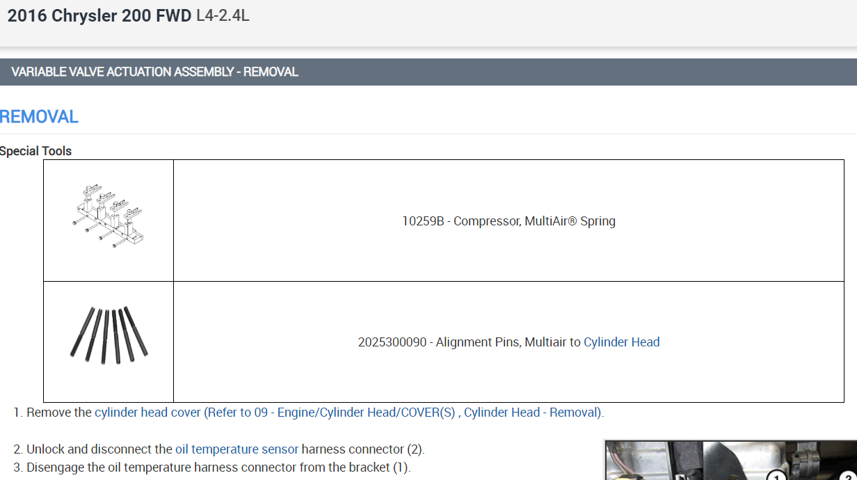

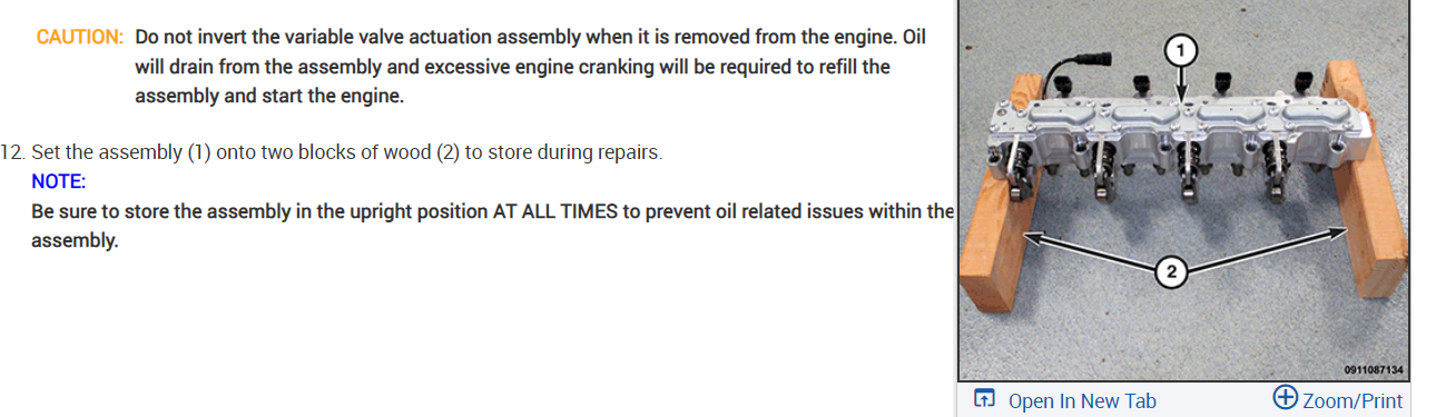

Chances are the camshaft actuators will need to be replaced, but the oil change should fix the problem for a while. Here is what the part is failing looks like. Check out the images (below). Please let us know what happens.

Okay, thanks for the information and pictures, it's very helpful. I will check over the guide you shared as well. But if all of that looks good, I plan on doing the engine work myself. I will make sure to respond with updates.

I finally was able to complete this work. I replaced the VVAA. I also replaced the timing chain, tensioners, water pump, etc. I test drove it today and ran the engine for over an hour. So far, no codes or issues. I’ll post back if something changes in behavior.
