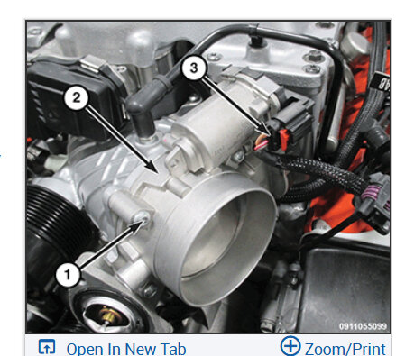

Vehicle stalls after being on idle for a while the Temp where I am has been in the high 90s and it happens with the ac on or off also when the vehicle has a quarter of a tank of gas’s and even when it’s completely full. When it happens it tells me to put it into park and restart the engine

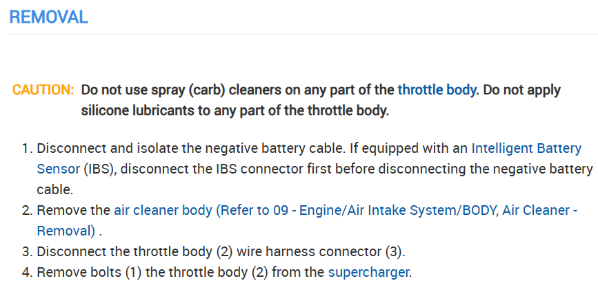

I have seen a vacuum leak cause this as well, how many miles does the car have? If you have a lot I would service the throttle body as well. Here are 2 more videos to help us.
https://www.youtube.com/watch?v=xN5pcM-5bso
and the throttle body service on a similar dodge.
https://www.youtube.com/watch?v=Ui8zhMLp5EM

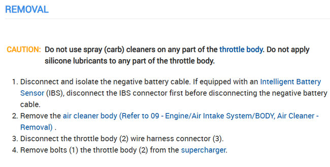

Here are the instructions for your car in the images below. Please let me know.
