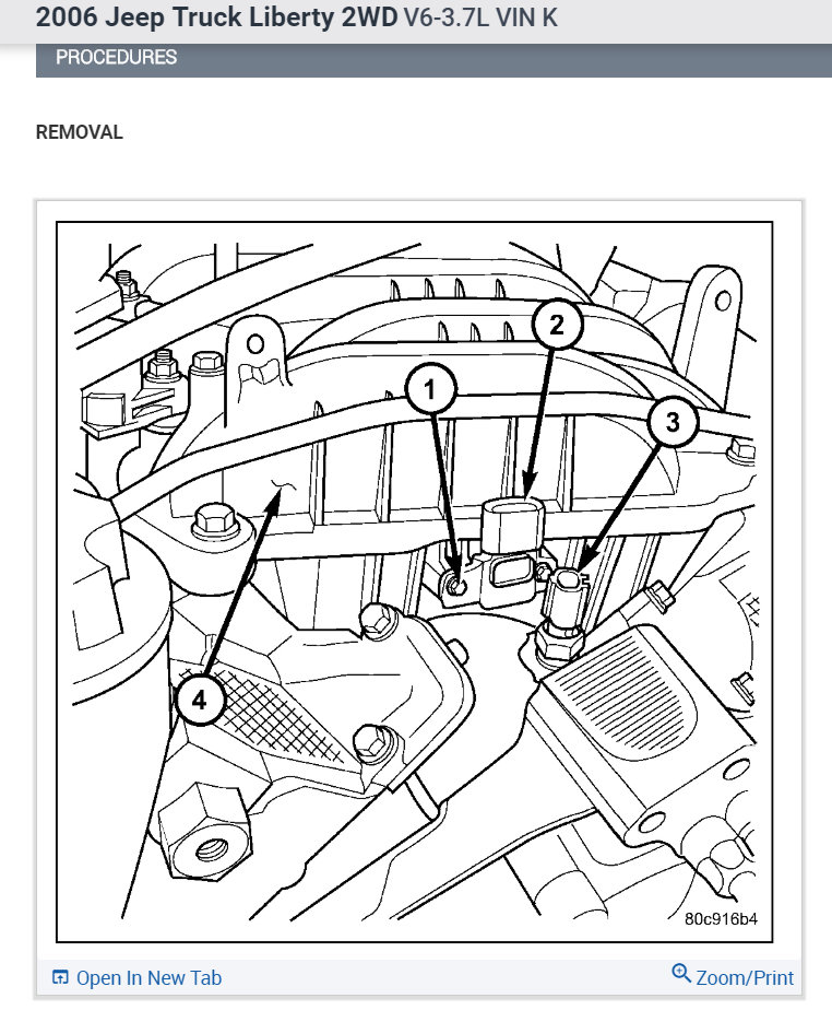

New plugs, coils, injectors, cam sensor, crank sensor, TPS, ASD, transmission, ECU. Still random misfires!

Can you please check for any vacuum leaks, especially around the intake manifold. A vacuum leak is notorious fire causing misfires, random misfires, and a whole list of other driveability concerns. Here is a link for you to go to below:
Please go through the guide and get back to us with what you are able to find out.

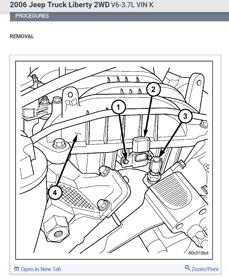

If I can jump in here, I have seen the MAP sensor do this I would remove it and see if it holds vacuum here is the location. Check out the diagrams (Below). Please let us know what you find.
