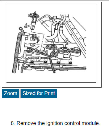

I started getting some really bad misfiring on the way to work one morning. I used my code reader and picked up a P0301 and then P0300. So I went and got a spark plug to change the one on cylinder one. After doing so the engine still ran rough. I decided to change all of them and coming onto the third cylinder I found oil in the well. The plug was fairly saturated with oil. This was the only one like it. After reading about possible causes, it seems that I will have to remove the valve cover to replace a gasket for the spark plugs. Is there any information as to what exactly would need to be done? I usually do most of the work on my vehicles but do not really know the starting point for this job.

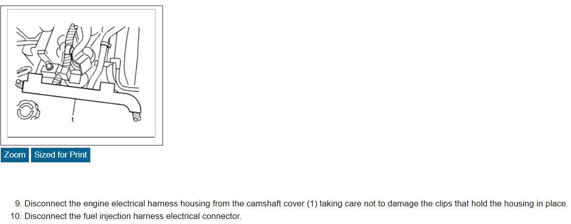

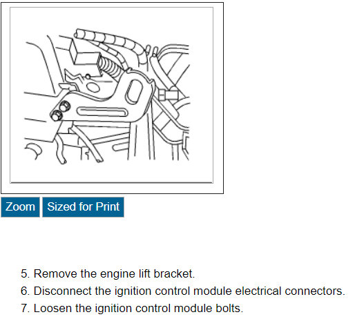

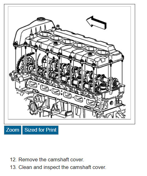

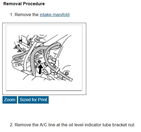

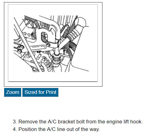

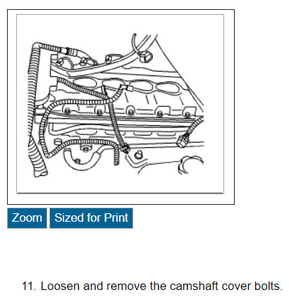

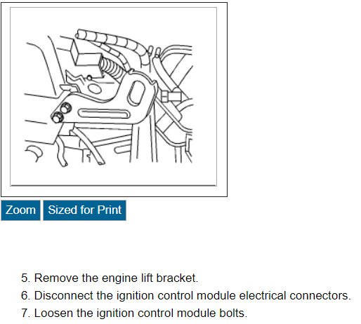

It sounds like the valve cover gasket is causing the problem. Here is a guide to show you what you are in for when doing the job and diagrams with instruction below on how it is done on your car:
https://www.2carpros.com/articles/replace-valve-cover-gasket

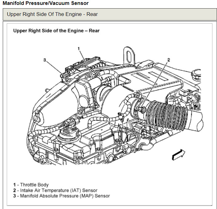

After you are done I would check the MAP sensor which can be off a little causing a random misfire code.
