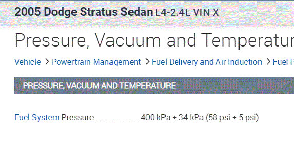

The gas cap is likely not related. However, there are other things that can cause issues.
First, when you notice the check engine light flashing, which is an indication of a misfire. Otherwise, it would stay on solid. So, I need to know if the P0303 is the only code that is present.
Next, things such as engine vacuum leaks, fuel injection issues, fuel pressure issues, and so on can all contribute to a misfire. By chance, has fuel pressure been checked? If not, do that and confirm it isn't too high or low.
Here is a link that shows in general how it's done:
https://tipmrebuilders.com/product-category/2006/dodge-2006/caravan-dodge-2006/
If you look at pic 1 below, it shows the manufacturer's fuel pressure specifications.
Let me know what has been done so far and if you notice anything when you experience trouble. For example, is there any black smoke from the exhaust or odd odors?
See pic below.
