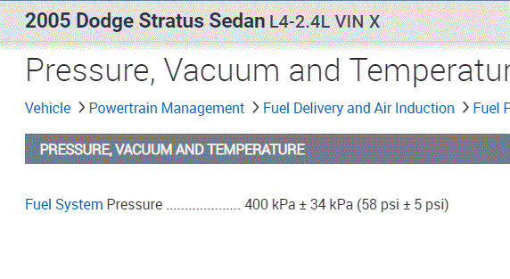

The gas cap is likely not related. However, there are other things that can cause issues.
First, when you notice the check engine light flashing, which is an indication of a misfire. Otherwise, it would stay on solid. So, I need to know if the P0303 is the only code that is present.
Next, things such as engine vacuum leaks, fuel injection issues, fuel pressure issues, and so on can all contribute to a misfire. By chance, has fuel pressure been checked? If not, do that and confirm it isn't too high or low.
Here is a link that shows in general how it's done:
https://tipmrebuilders.com/product-category/2006/dodge-2006/caravan-dodge-2006/
If you look at pic 1 below, it shows the manufacturer's fuel pressure specifications.
Let me know what has been done so far and if you notice anything when you experience trouble. For example, is there any black smoke from the exhaust or odd odors?

As far as the spark plug wires at the coil, they do click in, but to remove them I always give them a twist when pulling. Just make sure you are holding it at the boot and not the wire.
I honestly don't feel the wires are the issue. The idea that the idle is low and rough may be something as simple as an engine vacuum leak. That will cause a lean fuel mixture and oftentimes, it will cause a misfire and rough idle.
So, take a look through this link. It explains how to locate and repair a vacuum leak. Try this and hopefully, it helps.
Also, if your scan tool has a live data setting, I need you to check two things, short-term fuel trims and the signal from the engine coolant temperature sensor.
Let me know. Also, since the misfire has moved from cylinder two to cylinder three leads me to believe it isn't the coil either. The coil for the 4-cylinder engines fires two spark plugs every power stroke. One plug is the cylinder under compression, the other cylinder fires on the exhaust stroke. Cylinders 2 and 3 work on different coils, so it doesn't appear that one is going bad.
Let me know about the vacuum check and if you can provide the scanner info.
