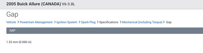

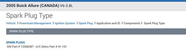

If the problem still persists I would move on to the ignition system next. New spark plugs is what I would recommend first. In the diagrams down below I have included the Original Equipment Manufacturer[OEM] part number for your reference and the recommended gap for you as well. Please keep us informed as to the results, and we can go from there, if needed.

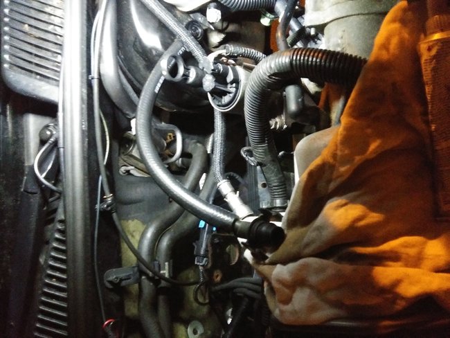

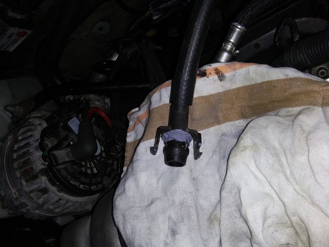

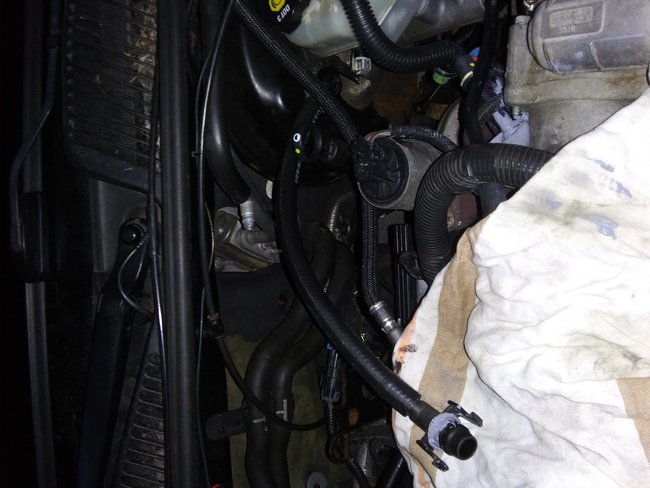

I replaced the booster line but I can't find a replacement part for where it connects to the intake manifold? I have a PCV valve on the left side of motor (standing in front of car) and a fitting on the back of the upper intake and it's a little loose, and I want to replace it but no one knows what this part is? 2005 GM Buick 3800 series 3 3.8l engine(non turbo).help!

Okay, if it's a tube coming from the exhaust manifold then it is the Exhaust Gas Re-circulation[EGR]. If it's a hose it could be Idle Air Control[IAC], Evaporative Emission[EVAP], or Positive Crankcase Ventilation[PCV]. It could also be a coolant line going either into or out of the heater core. Where does whatever that attaches to it go to?

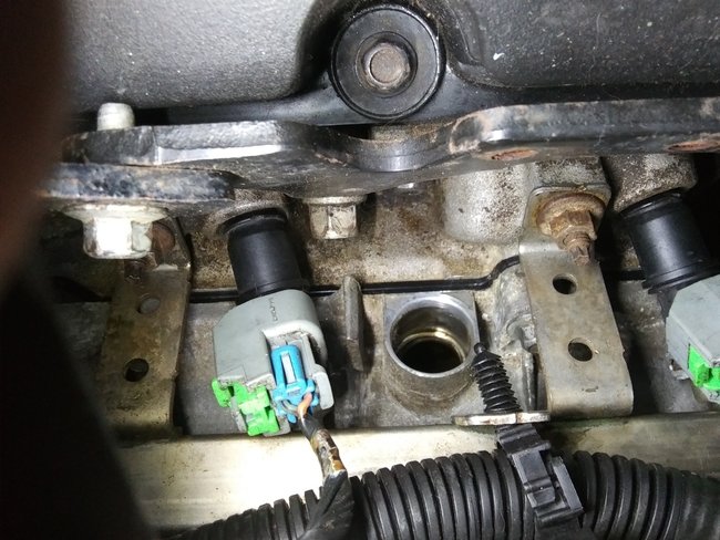

This the the upper intake. Picture is upside down. You can see the edge of new plenum gasket (black line). I just put some permatex high temp around the outside edge and a new o-ring on the black plastic piece.This should make a good deal.

Hello again, I see the upper plenum, what I am asking, my friend, is where does the other end of the hose go to, or come out of, depending on how you look at it. So not the end the goes into the upper plenum, but follow the hose and let me know where the hose leads to, please.

My mistake, it goes into the upper plenum. I was calling it the upper intake. The vacuum hose is coming from the brake booster down to this hole into the upper plenum. (My mistake. I'm a back yard mechanic)

I'm sorry too. I thought you were another customer. This looks like it will seal fine. You did a good job it looks like with the permatex. Very nice bead. Happy New Year.
