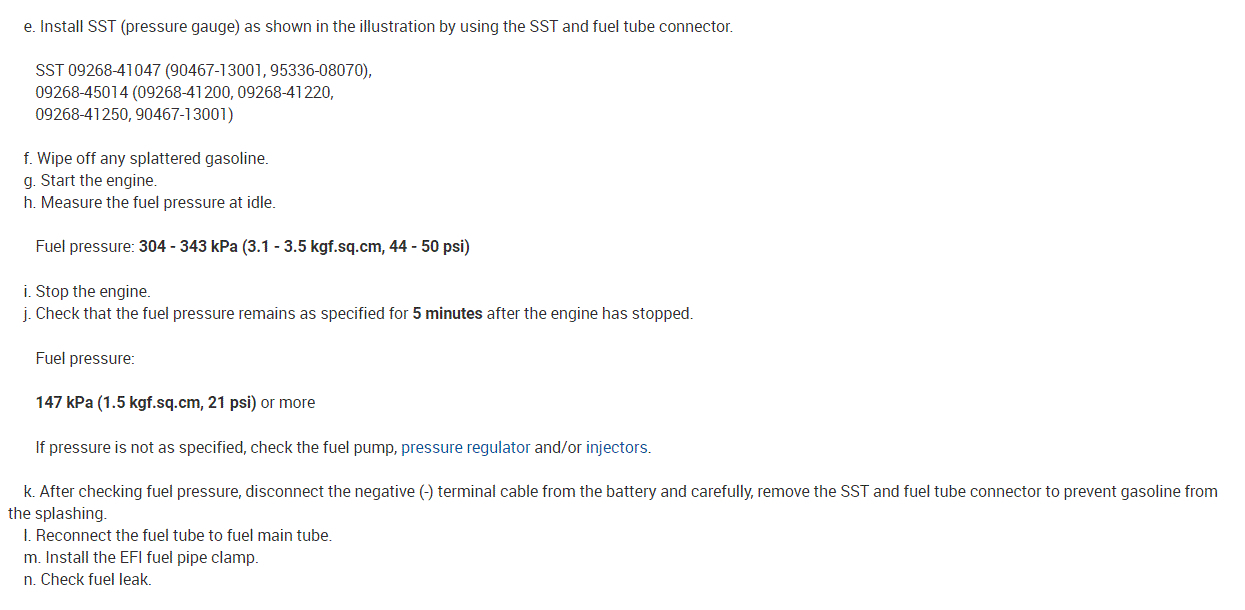

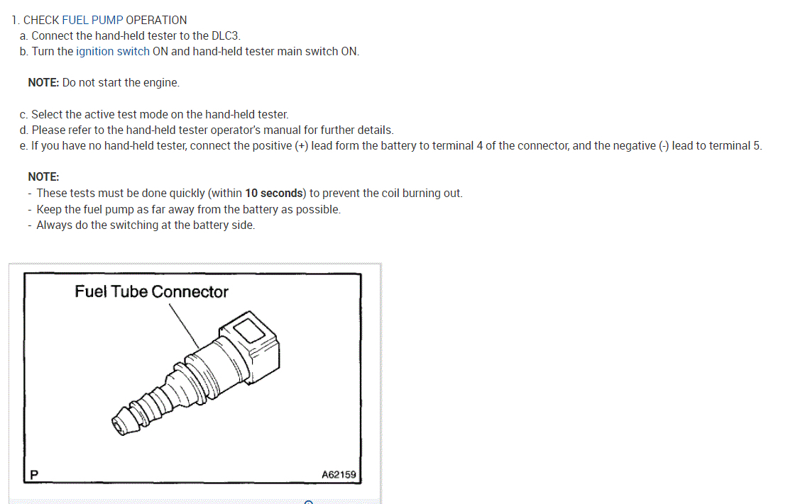

  • 109,885 POSTS

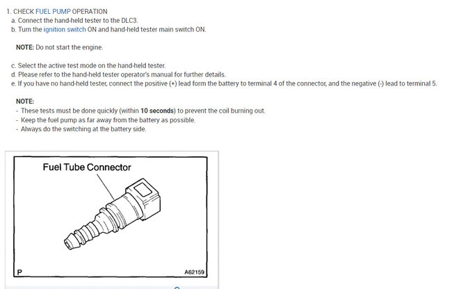

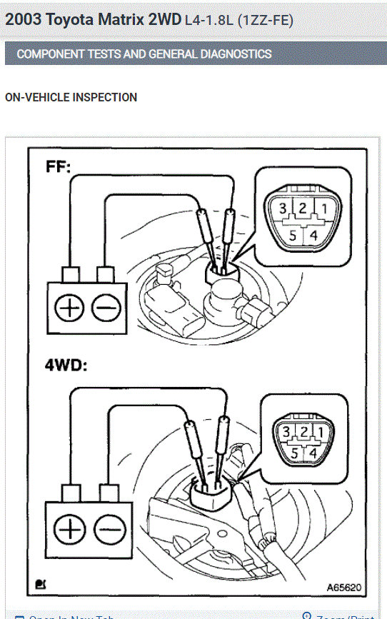

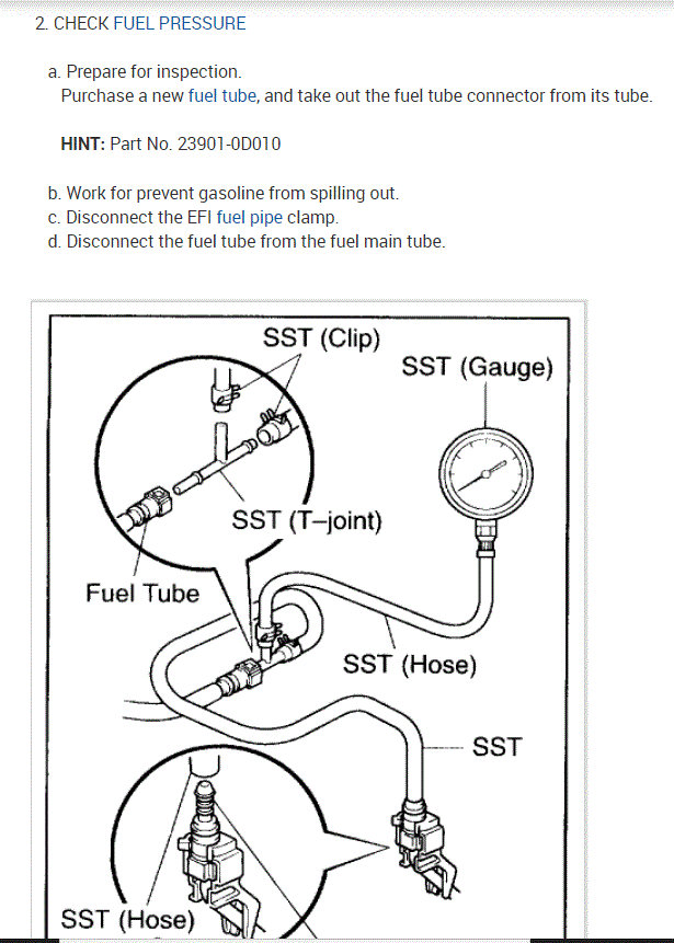

It is centered on cylinder 1 now. The P0171 indicates a rich fuel mixture. Are you certain the fuel pressure isn't high? If I recall, you didn't test fuel pressure yet and a leak down. That is what I recommend at this point.
Here is a link that shows in general how it's done:
I attached the directions specific to this vehicle below. They include the manufacturer's fuel pressure specifications.

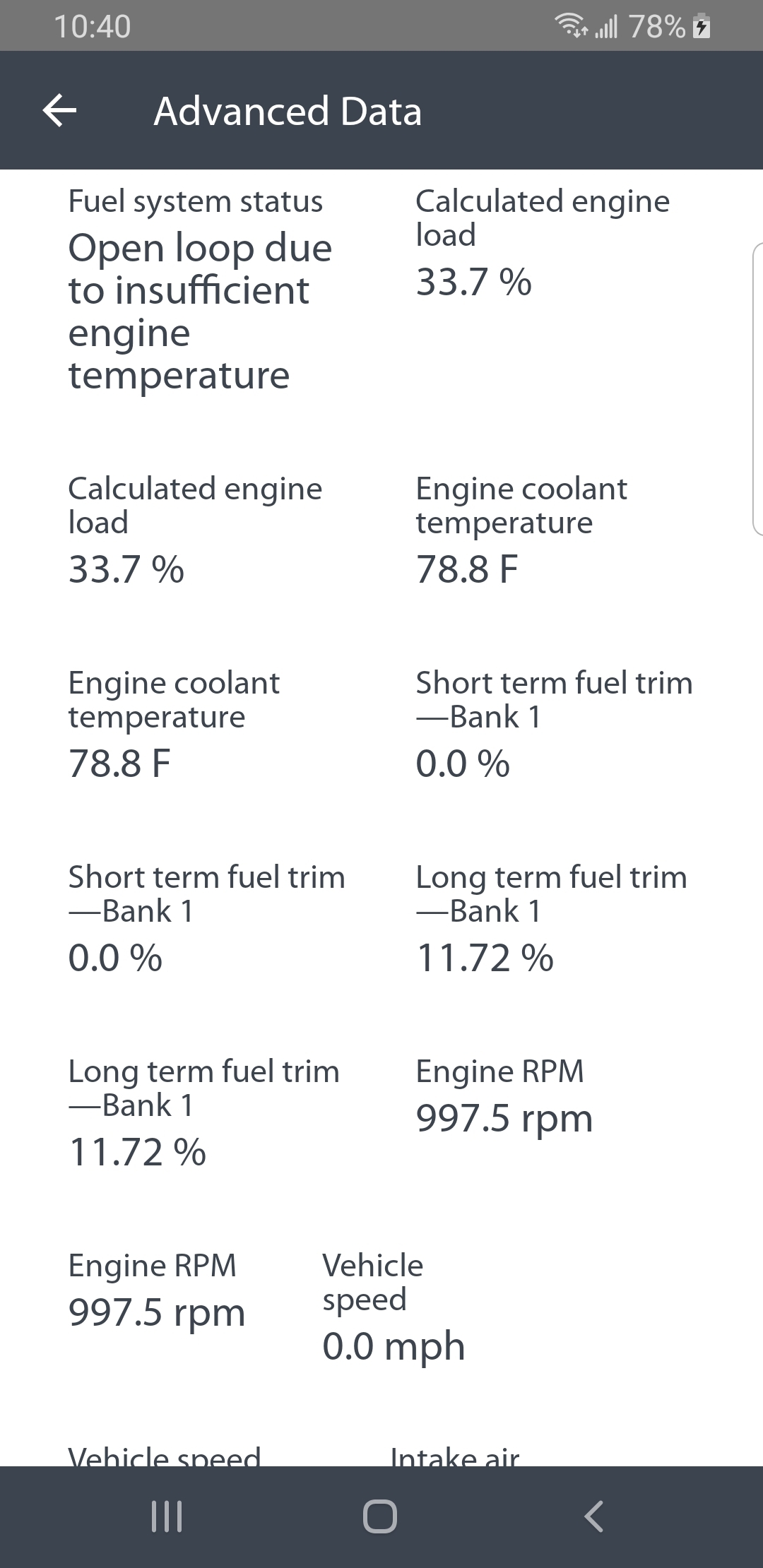

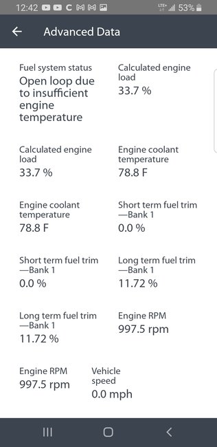

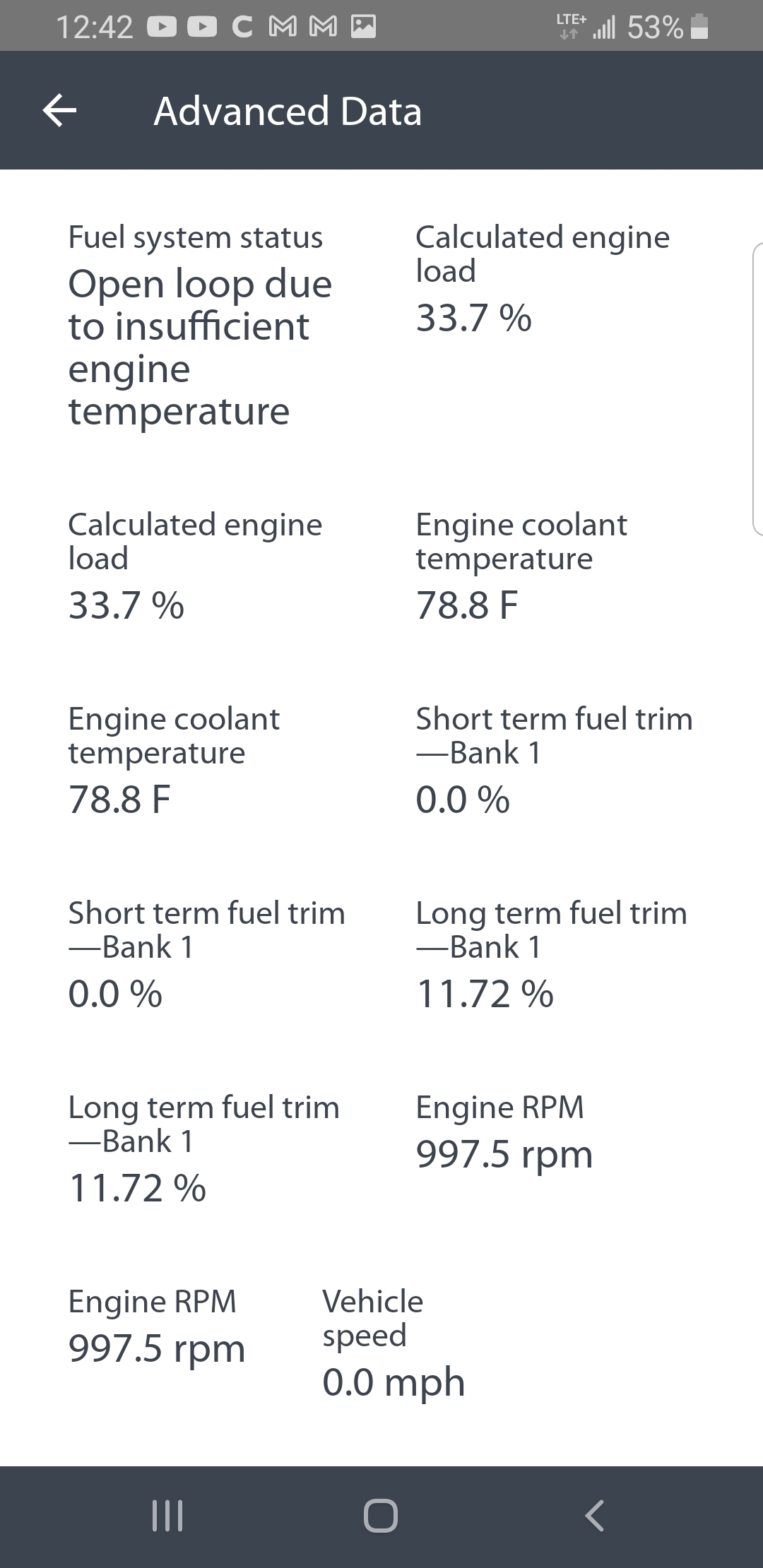

JAKESJ408
  • 13 POSTS

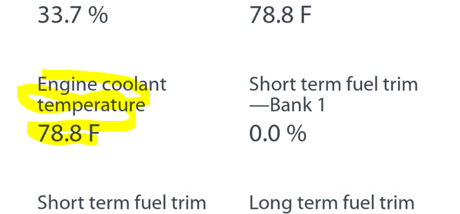

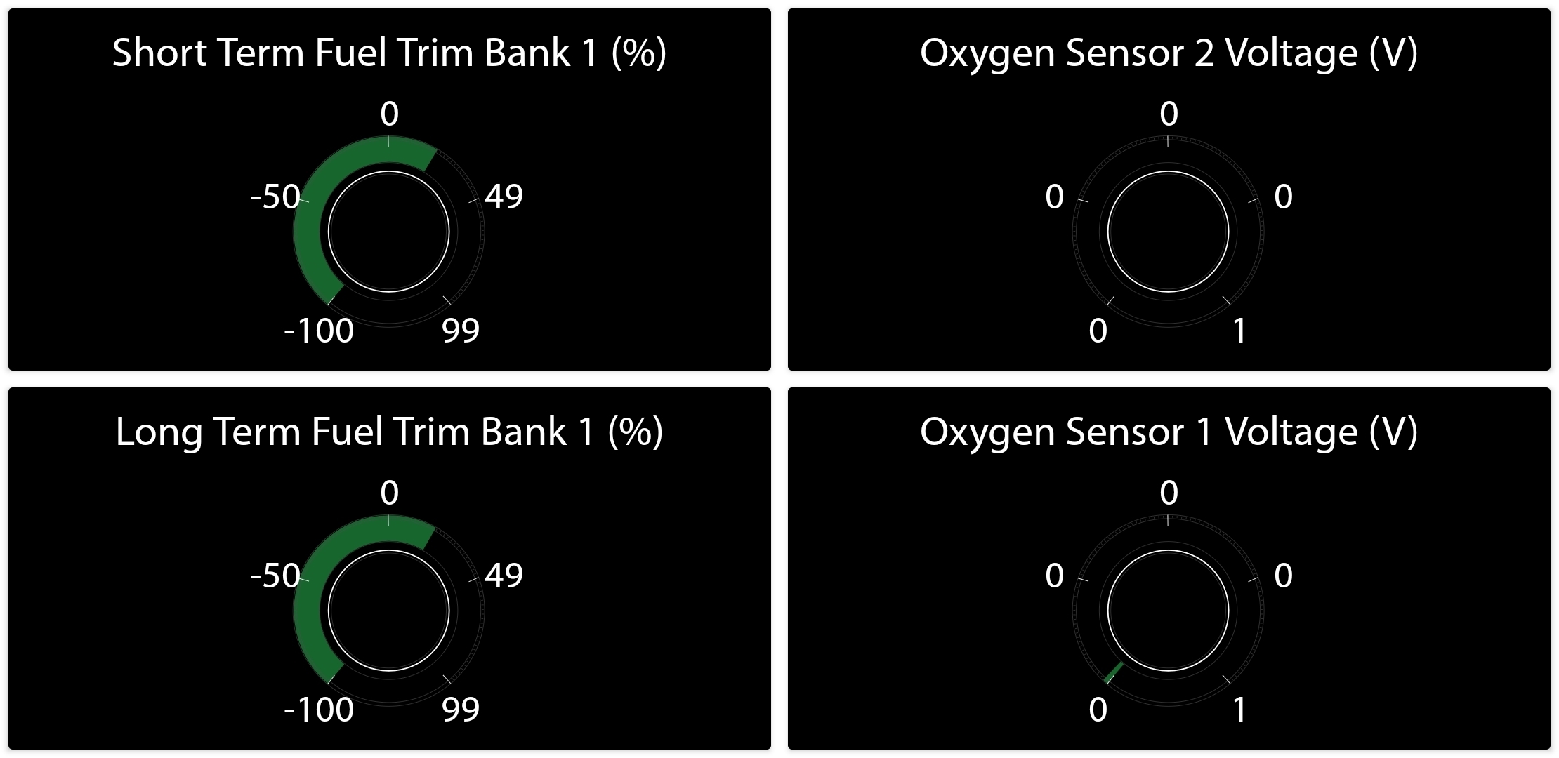

Here's the freeze frame data from this morning.
Wednesday, September 8th, 2021 AT 10:42 PM

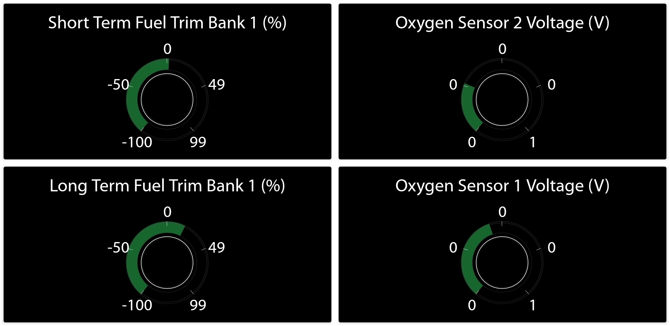

JAKESJ408
  • 13 POSTS

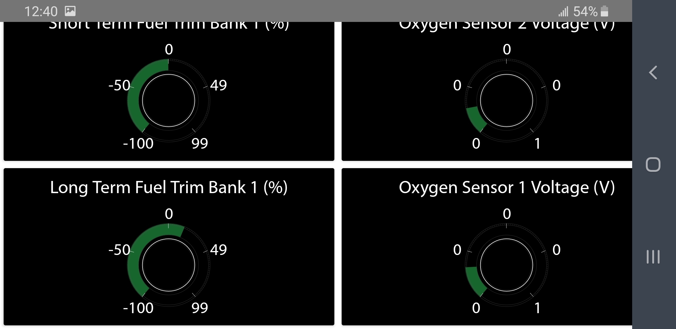

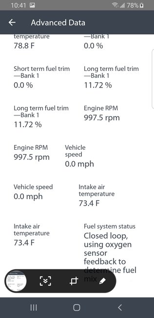

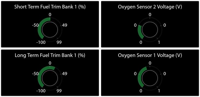

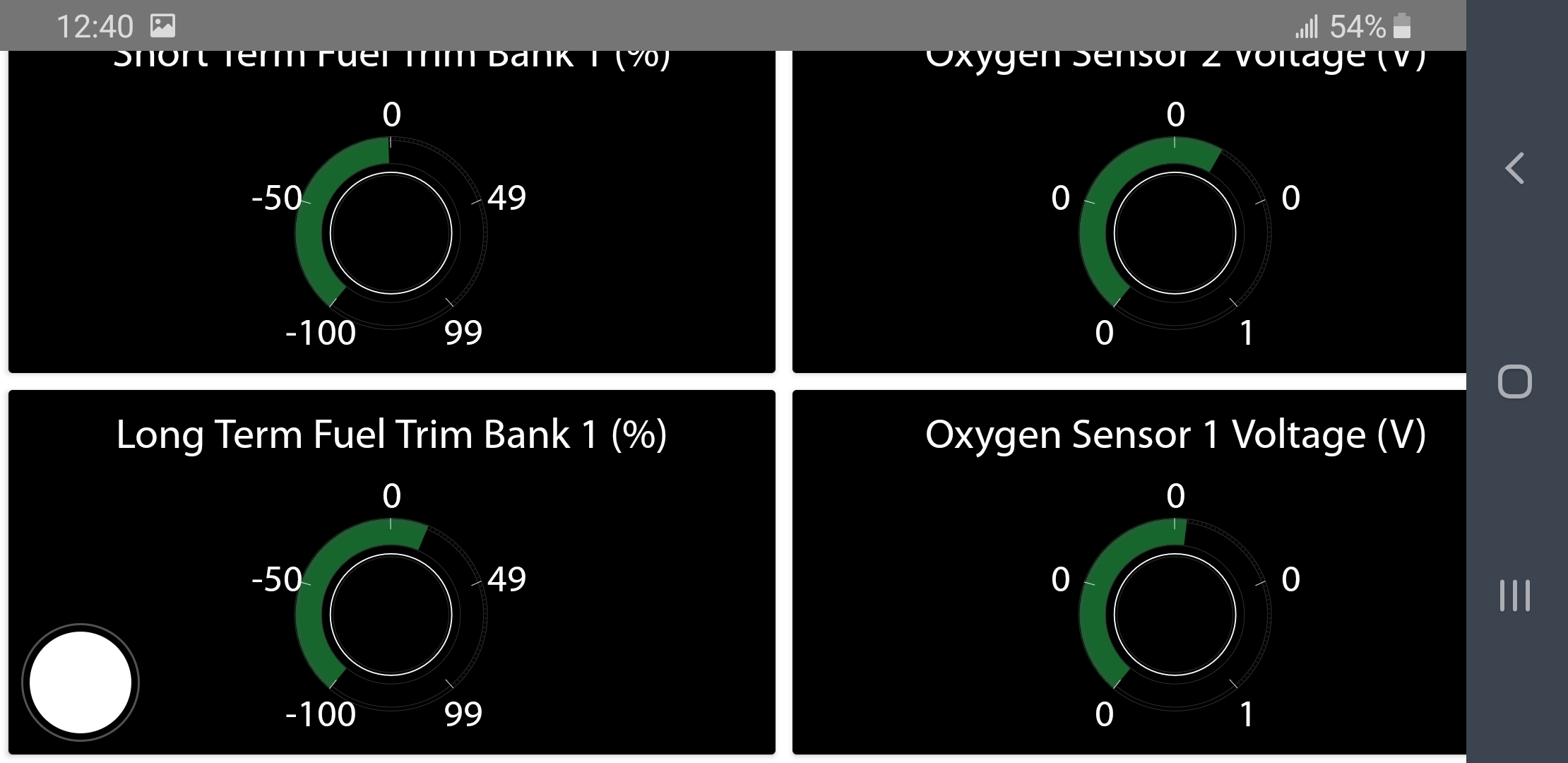

Here's the live data from today along with the freezeframe again hope this helps. 1st pic is at idle 2nd under load about 10 MPH 3rd at 35 MPH 4th at 40 MPH.
Thursday, September 9th, 2021 AT 1:33 PM
  • 109,885 POSTS
Every pic shows -100 on the trims. The PCM is trying to eliminate the amount of fuel entering the engine. It's running very rich.
I have a question because I'm not familiar with your scanner. All the O2 voltages are in the 0 range. Normal voltages will be between.1v (lean) and.9v (rich). Do the voltages on the scanner vary or do they stay constant? Was the engine at operating temp?
An O2 sensor's voltage should cycle normally with constant frequency. An O2 sensor stuck at a fixed voltage (0 is what I see) is an indication of an open O2 circuit or lack of O2 sensor ground.
Thursday, September 9th, 2021 AT 3:49 PM
JAKESJ408
  • 13 POSTS
They only moved when I accelerated that gas pedal.
Thursday, September 9th, 2021 AT 5:09 PM
JAKESJ408
  • 13 POSTS
Yes engine was at operating temperature when I took the screen shots of the live data. I'm using "Fixd" as my live data source.
Thursday, September 9th, 2021 AT 5:10 PM
JAKESJ408
  • 13 POSTS
So I'm taking it than it's the o2 sensors? If so what ones do I replace all or can I get away with just one I know it's best to replace all at the same time but tight budgets.
Thursday, September 9th, 2021 AT 5:12 PM
  • 109,885 POSTS
If there is no variation in voltage at an idle, it sounds like we have bad O2 sensors. It should show some variation in voltage at idle.

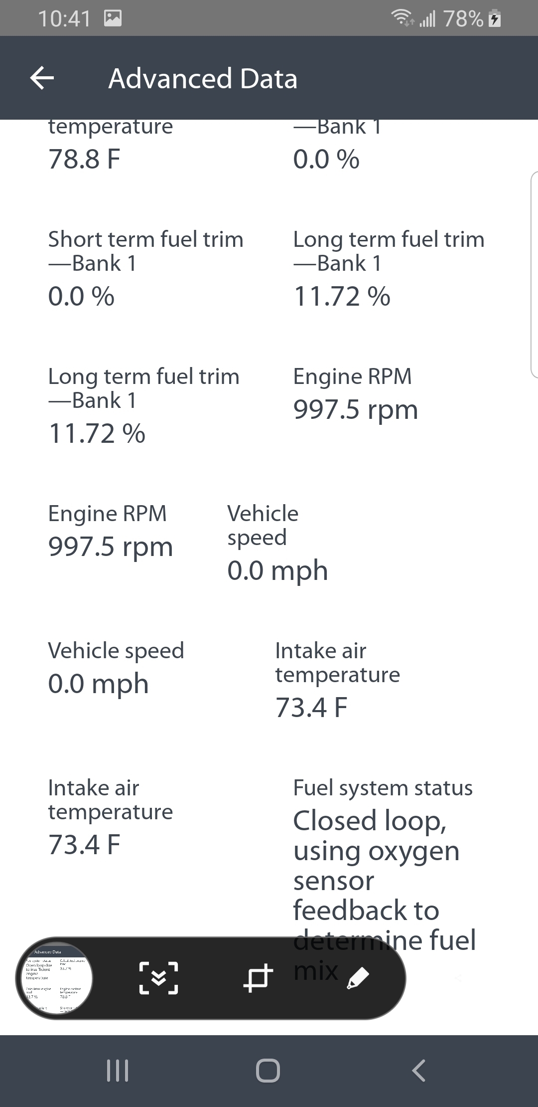

Next, and the reason I asked about the engine temp when tested, is because the last pic above indicates the engine coolant temp at 78.8° F. If the engine is warmed up and that is what it is signaling, the computer is compensating a rich fuel mixture when the engine is much hotter than it thinks. Thus, the rich fuel mixture.
Thursday, September 9th, 2021 AT 5:18 PM
JAKESJ408
  • 13 POSTS
That freeze frame is when the car first started and the code was thrown the engine was just warming up.
Thursday, September 9th, 2021 AT 5:20 PM
  • 109,885 POSTS
Okay, that makes sense. At this point, we need to check the sensors. If they are not changing voltage signals at all, I have a feeling they could be the problem.
