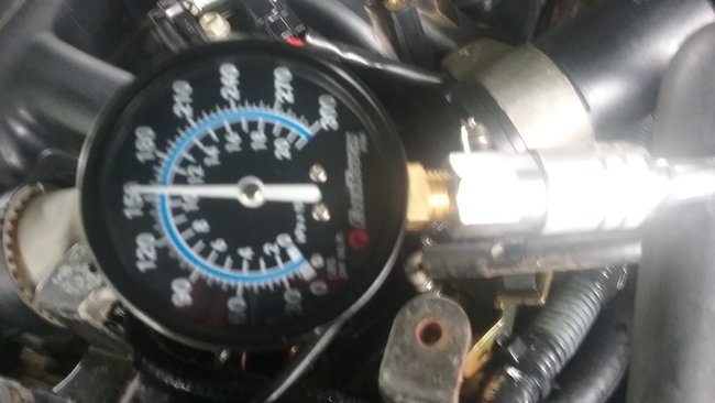

I am having a problem with misfire I check cylinders one through five by taking coil off no result. I took two cylinder coil off engine gets weak. I replaced coil packs and boots. I replaced all the plugs, replaced both valve covers, a variable valve timing solenoid. I disconnected the fuel Injector that runs to cylinder two and before I tried that it makes a loud popping sound even with the fuel injector disconnected. can you please tell me what I need to do?

start with a compression test and please post the results.

Okay, I did a compression test both cylinders two and four were 150.

Can you do the rest of the cylinders becasue if you have a burnt intake valve it will effect the remaining cylinders.

Did the rest of the cylinder 120 all around
