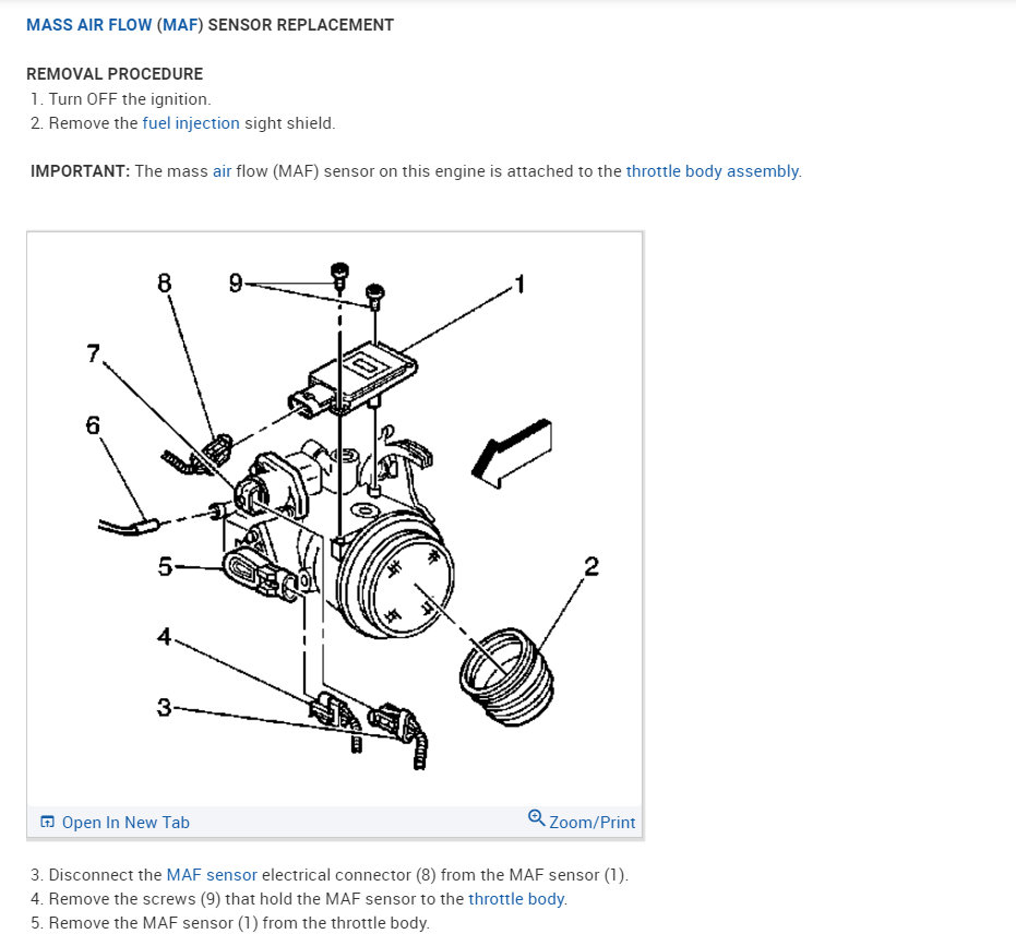

Came up with 0P0300 code. I changed coils, plugs, TCS, MAP, injectors, cleaned EGR valve, and still has severe misfire. Also, I lost acceleration going up hills, and engine shudders when I push the gas. Help!

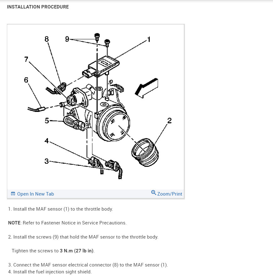

Hello, it looks like you have changed a lot of parts, have you cleaned the Mass Air Flow sensor? Most engines have either a MAP or a MAF, but it looks like your car has both. The Mass Air Flow sensor is in the air intake tube going to the throttle body. I'll put a diagram of it below, but the MAF has a resistor on a hot wire that measures air flow into the engine. If it is dirty, it will under report the amount of air coming into the engine and there will be a lack of fuel delivery. You can buy Mass Air Flow cleaning spray to clean the sensor. If cleaning the Mass Air Flow sensor doesn't help, we can look into some other issues. But what did the spark plugs look like when you took them out? Were they all black with soot and carbon on them?
https://www.2carpros.com/articles/mass-air-flow-service
https://www.2carpros.com/articles/engine-has-low-power-output

All plugs were black, and I pulled the MAF out today and I'll get cleaner tomorrow. Check engine light has been on and flashing.

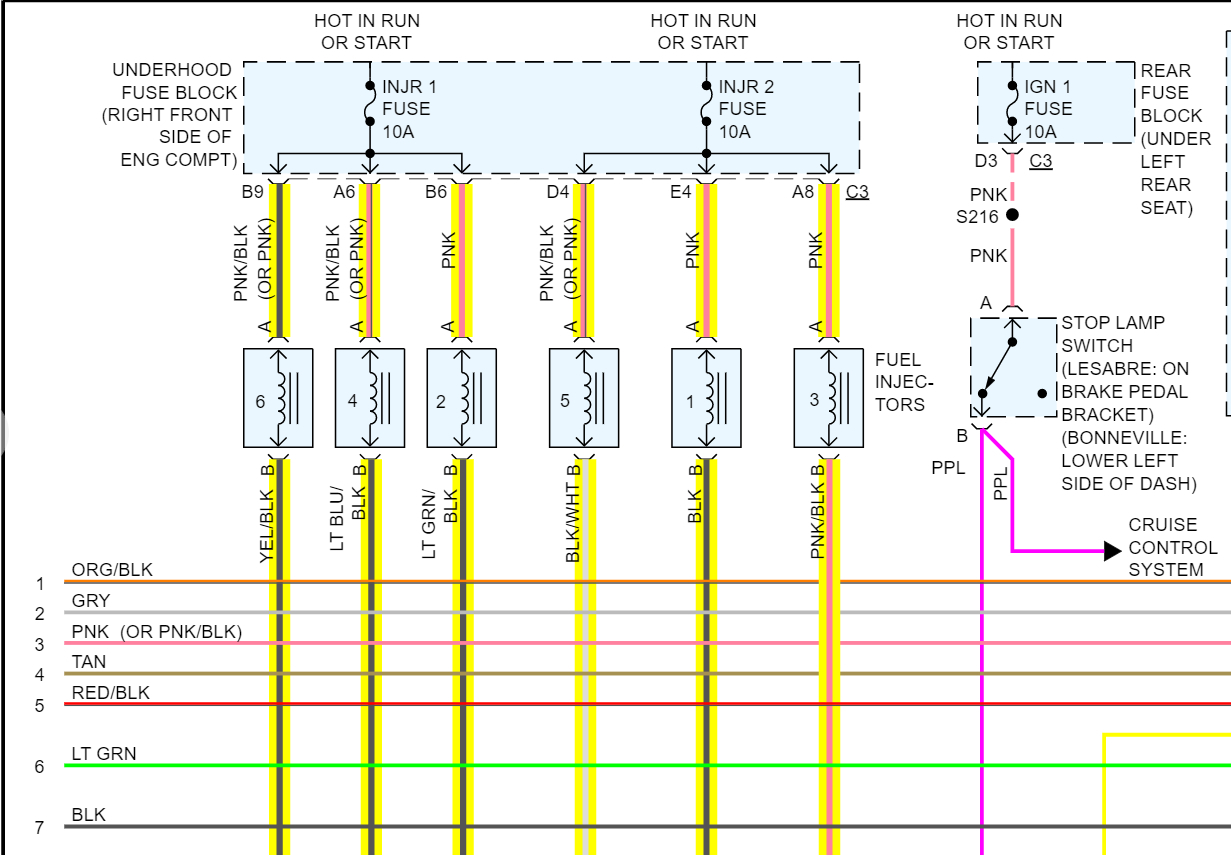

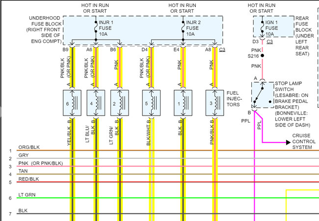

Okay, here is a wiring diagram of the Fuel Injectors, you will notice they are powered up by each engine bank. These can be checked with a 12-volt automotive test light. Power and control. I'll put the guide for testing the injectors too. Just to make sure you're not having a wiring issue to the injectors.
When cranking the engine over, does it sound like an equal cranking type sound, nothing noticeable like a weak cylinder? With compression issues you can notice an engine cranking that sounds a bit off.
https://www.2carpros.com/articles/how-to-test-a-fuel-injector

I do know that I pulled the connectors off of each injector and the front right and back left injectors made no difference in the engine performance.

Okay, good, so you did a cylinder balance test. I was going to ask you to do that.

Would those 2 not making a difference be an issue with the wiring?
Jul 8, 2022 at 9:41 AM
AL514
  • 5,639 POSTS
It means that those two cylinders are not contributing to engine power output. Checking them with a test light to verify they're getting power and are being controlled by the ECM will at least rule that part out. Do you hear them clicking if you put a long screwdriver up to them and listen? They should sound the same as the other injectors. So, you know so far that you have two cylinders down. But follow the Fuel Injector test guide and see what you get. Since you replaced all the injectors, you may have had a couple of the old ones that were shorted out, and when fuel injectors short out they can burn the ECM driver for those injectors. This will cause the new ones you put in to not function at all. When you do the control test with the test light, it will not flash.
