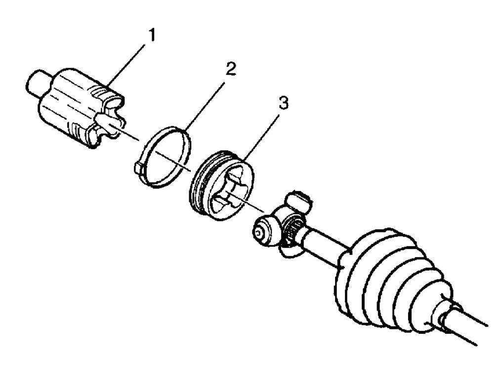

Ok I've changed the tie rods inner and outer, changed the sway bar drop links in the front and back changed the sway bar bushings in the back. My car while driving down the road will randomly jerk from side to side and feels like a tire is about to come off. It's especially bad if I hit a rough patch on the driver side. Also strange is when this happens the worst I start smelling burnt transmission fluid. Also have changed the struts
Feb 12, 2026 at 2:02 AM
STEVE W.
  • 15,418 POSTS
That description sort of sounds like a bad tri-pot joint. Those are the inner CV joints on the axle. Is it possible that the drivers side was pulled out too far during the work and lost one of the bearings from the spider ? That could cause a random issue as the axle tried to retract and extend with the suspension movement. The smell could be coming from the seal that goes around the axle being forced away by the motion of the axle. You need to get it in the air and inspect the axles ASAP, before it damages the transmission case (may already be damaged).

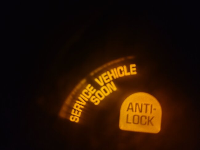

Okay well I went ahead and changed the driver side CV axle and upon doing so I held it from the middle and both ends just dangled dropped loosely so there was a whole bunch of slop in that axle now it pulls pretty bad to the left so obviously I need a front end alignment but now the "Service Vehicle Soon" not the "service engine soon" but the "Service Vehicle Soon" light is on as well as the "Traction Off" light and the "Anti-lock Brake" light is on. I know longer smell the transmission fluid when I test drove it so at least that's a good thing. All I did when changing the axle was remove the outer tie rod castle nut to lift it out the way and the 2 bolts on the strut and obviously the axle nut. Then put it all back together. So what would make all those lights suddenly come on?
Feb 12, 2026 at 2:36 PM
FRAZIER88
  • 53 POSTS
These lights
Feb 12, 2026 at 2:39 PM
FRAZIER88
  • 53 POSTS
First was upside down lol
Feb 12, 2026 at 2:42 PM
STEVE W.
  • 15,418 POSTS
Check the cable that goes to the speed sensor on the hub. If it was stretched or even moved a lot it may have broken internally.

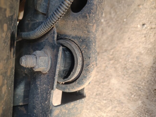

Should there be a little play in the transmission like this? It's not much but just curious?
Feb 14, 2026 at 5:01 AM
FRAZIER88
  • 53 POSTS
Only thing left I either haven't changed or doesn't appear bad
Feb 14, 2026 at 5:03 AM
STEVE W.
  • 15,418 POSTS
The rocking is normal. There has to be some clearance so that as the parts warm up and move they can move freely. Clicking while turning is commonly the outer joint on the axle, but it can be either side humming from a bad bearing can switch sides, clicking usually doesn't. A simple test, jack up the front of the car so both sides are off the ground. Start the car and turn the wheel so you hear the clicking, have someone listen to each side. I do this test alone but I lock one tire from turning to test the other side. If you didn't have clicking before it's possible you got a bad replacement, not an uncommon thing these days.
