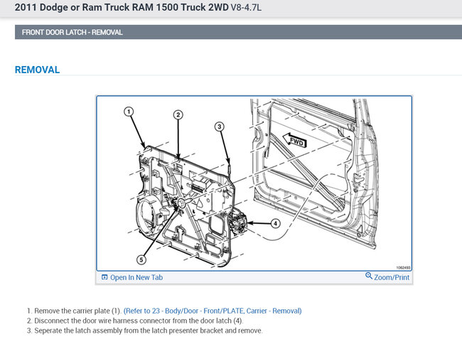

The truck alarm randomly goes off i think the owner before me had the truck broken into because there are pry marks on the passenger door. Could that be the problem?
Mar 31, 2023 at 3:00 AM
  • 55,273 POSTS
Yes, so what happens is the door latch could have done bad which included the latch monitoring switch which if it is on the edge of tripping it can give a false positive at anytime. To confirm this problem lock the truck and allow it to sit for 2 hours, then without doing anything with the keys try pulling on the passenger door to see if the alarm goes off. I would continue the test with all of the doors. Let me know what happens.
Mar 31, 2023 at 4:22 AM
KINGJD123
  • 104 POSTS
Okay, i can confirm that the passenger door tripped, what are the steps now?
Mar 31, 2023 at 7:40 AM
  • 55,273 POSTS

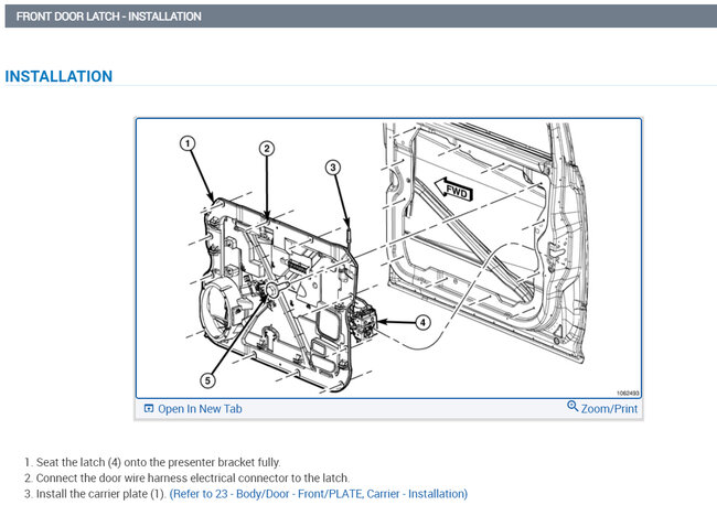

Nice work, you must remove the door panel and replace the latch assembly. Here are the instructions for the job in the images below. Please let us know what happens.
Apr 2, 2023 at 2:41 AM
