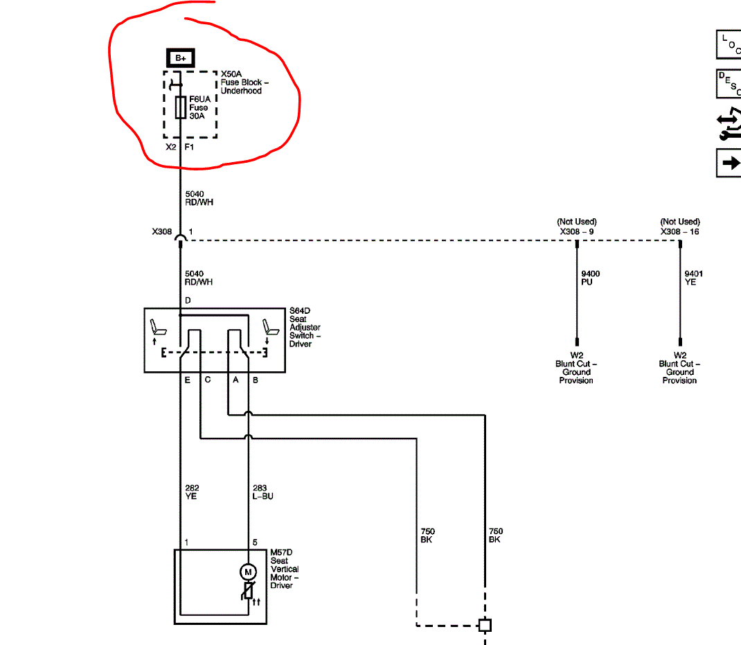

Cannot get the driver side seat raised.

The first thing I need you to check is a 30 amp fuse in the under hood fuse box. See the attached pic. This fuse powers the up/down movement of the seat.
Let me know what you find.
