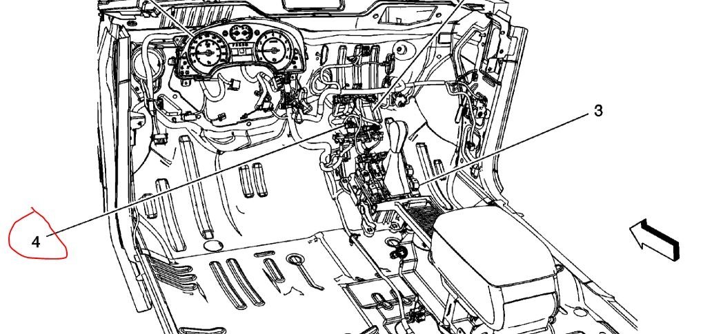

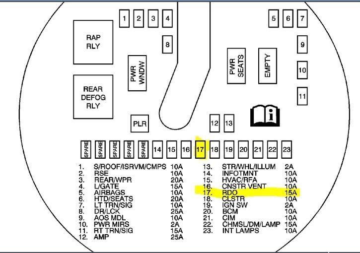

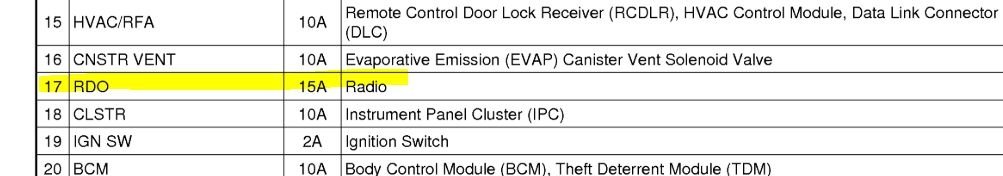

The radio will not come back on after my truck would not start. Now that my truck is fixed the radio still will not come on.
Sep 13, 2019 at 3:03 AM
Experienced Mechanic
110,248 POSTS
Welcome to 2CarPros.
The first thing I recommend checking is the fuse. The fuse is located in the passenger compartment.
I attached three pics to help you locate it. Also, here are a few links you may find helpful when checking:
