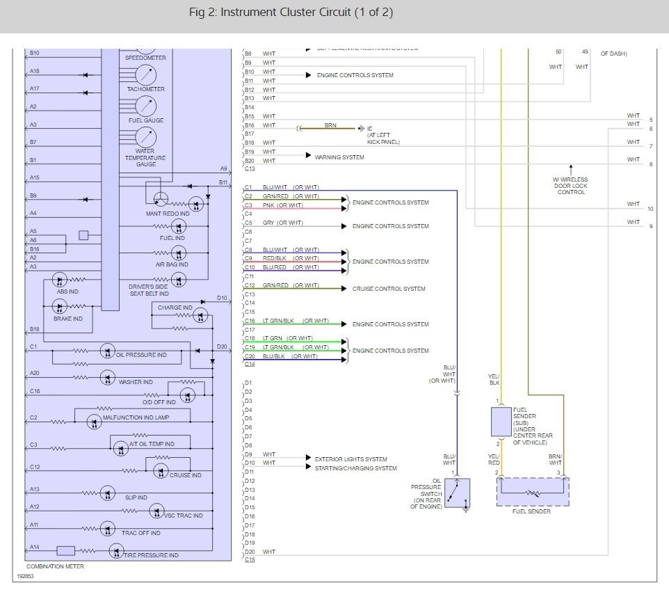

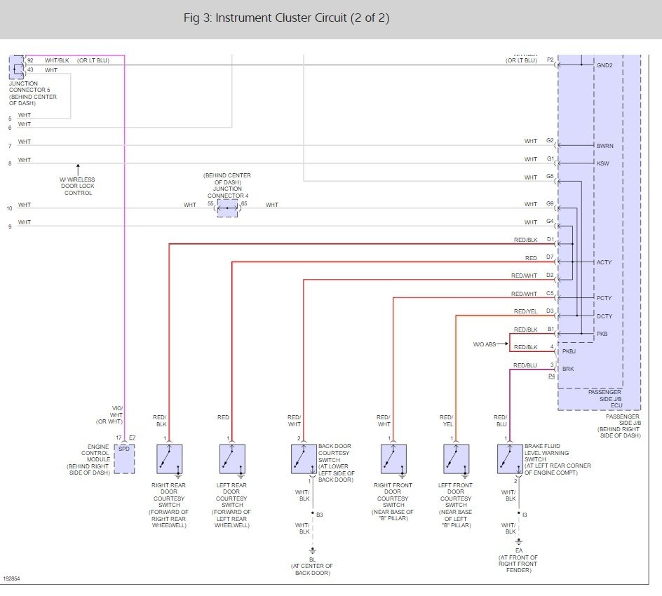

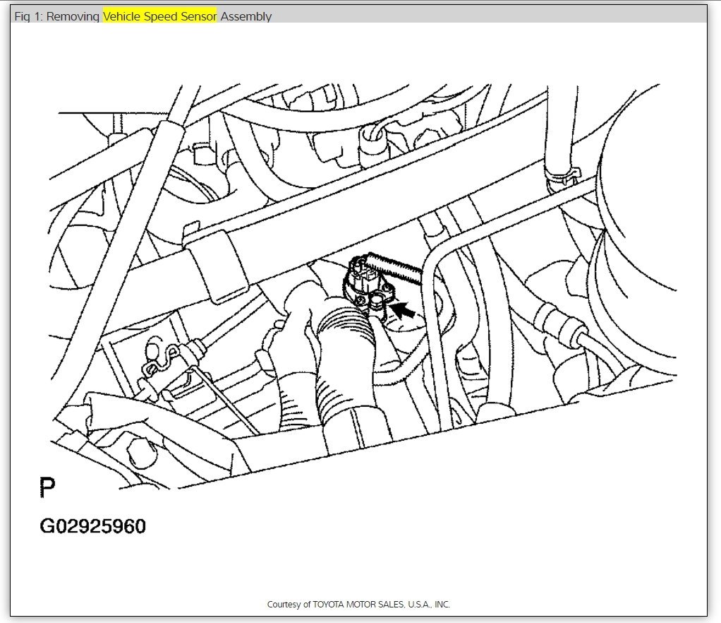

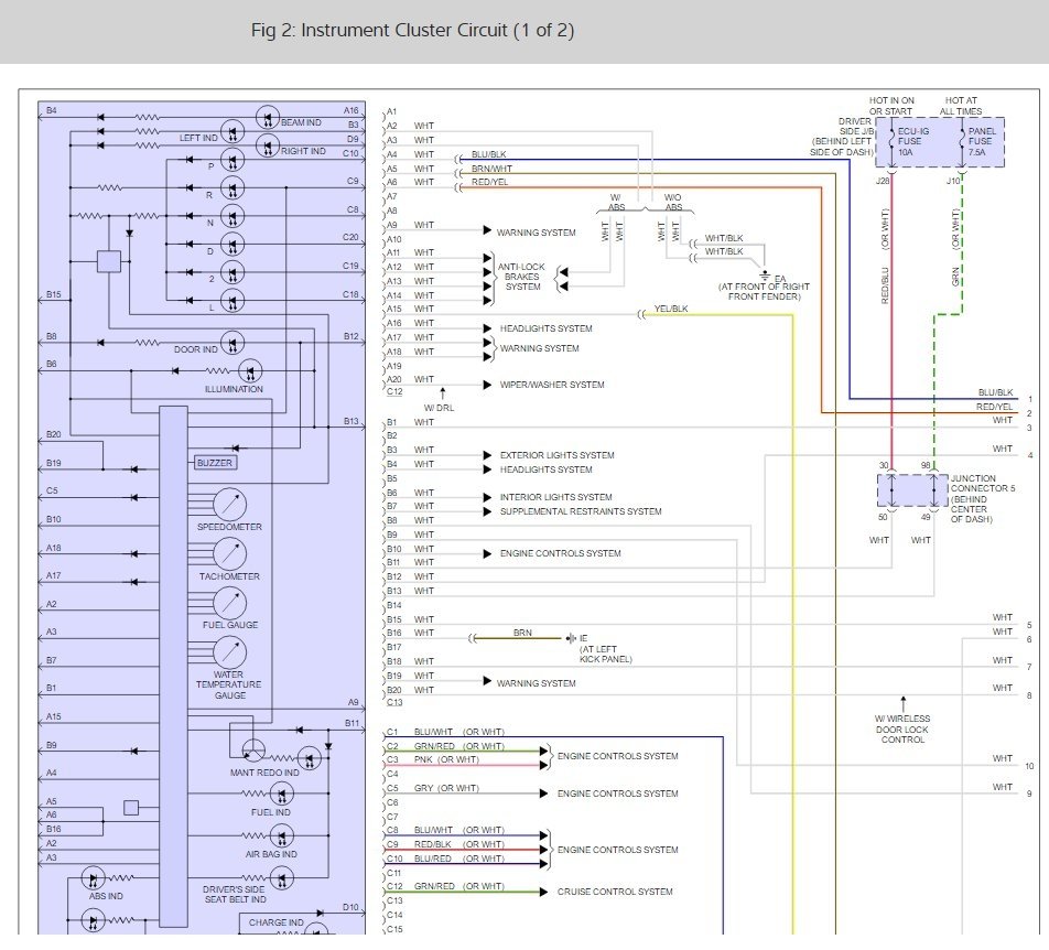

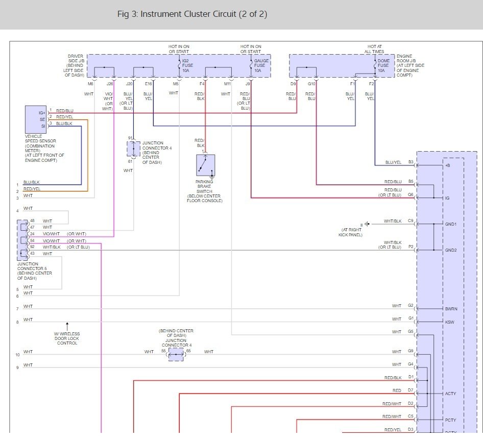

Your problem sounds more like the vehicle speed sensor has gone out. Here is a wiring diagram to help you do some testing for power at the cluster and a diagram of the vehicle speed sensor location.
and
Check the wiring at the sensor as well.
Please run some tests and get back to us so we can continue helping you.
