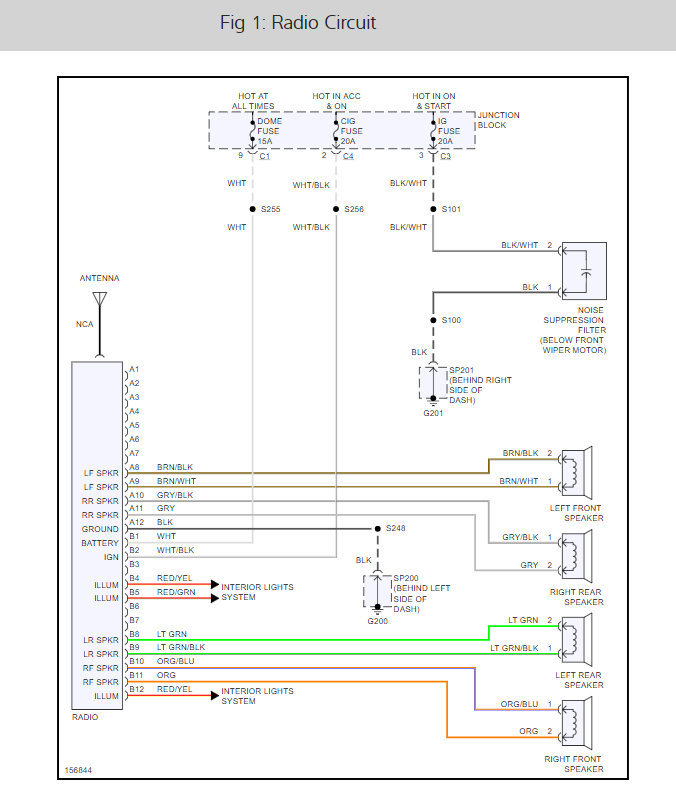

All the buttons work, but no sound from the speakers.worked yesterday, but not today.
Jan 15, 2020 at 7:43 AM
  • 55,214 POSTS
It sounds like the amplifier inside the radio has gone bad in which case you will need a new radio. To be sure there are 3 fuses that run the unit. here is a guide and the wiring diagrams form the radio that shows which fuses to check with a video of an aftermarket radio being installed in a similar car in case you need to replace it:
