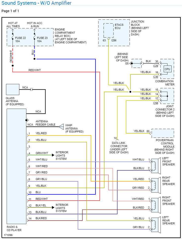

I cannot find the right wiring harness diagram for my car. I am a little mixed up also because i hooked up the constant and switched power and the radio will not turn on. The diagram I was looking at said the constant is a red and black wire but I do not have a red and black wire then a 2004 or 2002 diagram shows the red and white wire which is the one I have.

Here you go. Looks like the power supplies are blue and red/white. Here is a guide to help heck it with the diagrams below for your car.
